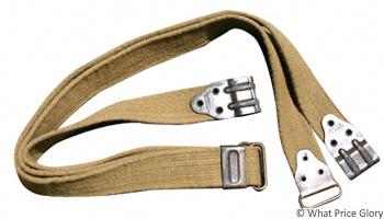

    Second question: regarding slings for the 1903A3, which one do you prefer? Here's a couple I've been looking at on different web sites. The first one is a (M1917 Kerr sling) in O.D. color...
    I think this one is too long for the 03A3, but they say it can be doubled up at the rear so it will work, and I actually like the O.D. color vs. the tan. Has anyone used one of these slings on your 03A3?
    I am also looking at this (M1903 Kerr no-buckle) it measures 14-1/2" on the short side and 46" on the long side, do any of you use this sling for your 03A3?
    Then there is the leather slings such as the Tuner and others, I think these slings really look good too on the 03A3's, but I'm wondering how well they would work in the field, like being stiff and bulky, and whether it would wrap around your arm as easy as the web sling?

    The first two (Kerr) slings you pictured were predominately WW1 issue, not common on the A3 rifles by the time they came along. By that time a couple other models came, (and went) the M1923, 1907 and M1icon web would be more correct. Even more would be the 1907 or the M1, your kerrs would be most fitting for a M 1917 rifle, that's why it's too long. There were 3 lengths for the Kerr, shortest being for the Thompson SMG, mid-length for the m1903 and longest for the 1917. There quite a few reproductions (Kerr) around and despite looking very nice are not as sturdy as the originals. Quite a few folks have found that the hardware bends and stretches when in use.
    Preference really depends on what your doing with it, competition normally demands the M1907 sling and it is still favored in most circles but the M1 is also correct and a close second. Third would be the M1923, many were still in use and available in both OD and tan. Due to complexity and poor favor with the GIs production was discontinued and orders were to exhaust supplies. Last would be the Kerr, it's really not correct for the A3 and I'm unaware of its use by WW2 other than on the Thompson or maybe a shotgun, really don't know, never saw one on an A3.

    Thanks for the reply Randy A, that's what I was looking for on the sling perspective . It sounds like the leather is the way to go for durability, although, I guess I would
    actually have to try a couple different styles to see which one works best for me. I appreciate the info.
