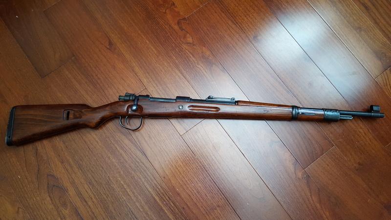

    Donor Rifle, Israeli 7.62 on a Czechicon receiver.

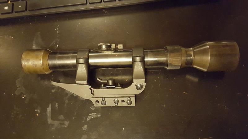

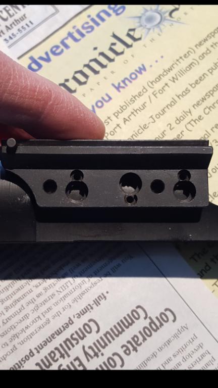

    After acquiring the rifle, I promptly bought the SSR mount.
    Here it is with the Meopta.
    Time to get to work!

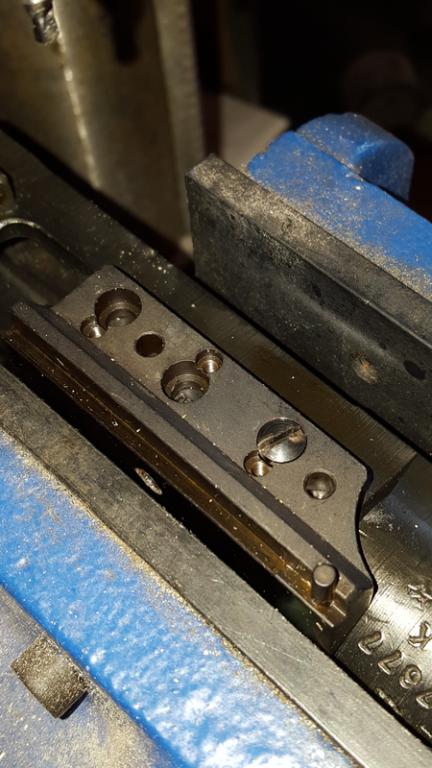

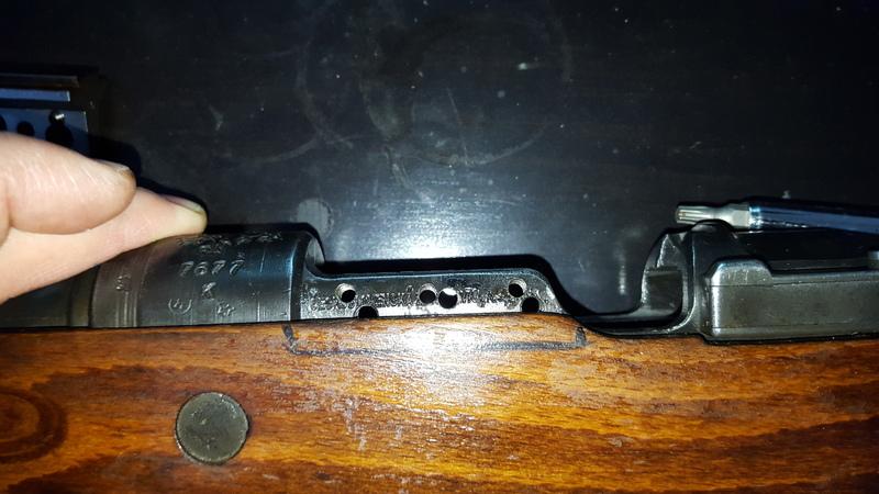

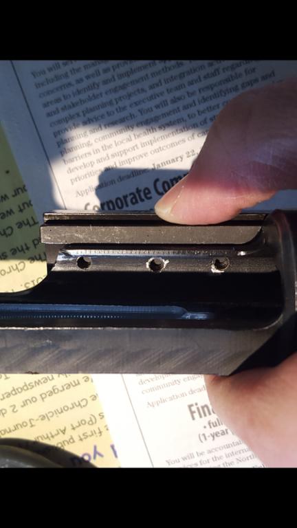

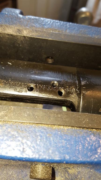

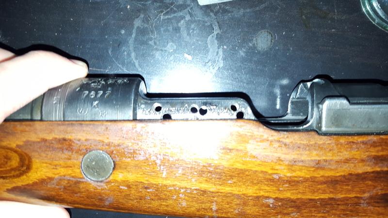

    Except, the holes in the rail were no where near where I needed them, but that was ok because I could go ahead with the build without having to wait to get the holes filled.
    No overlap.

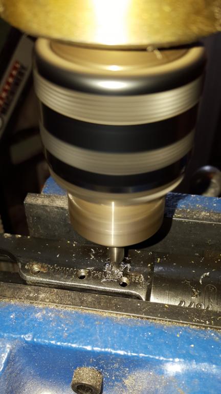

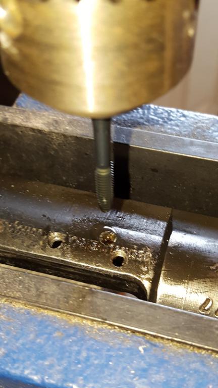

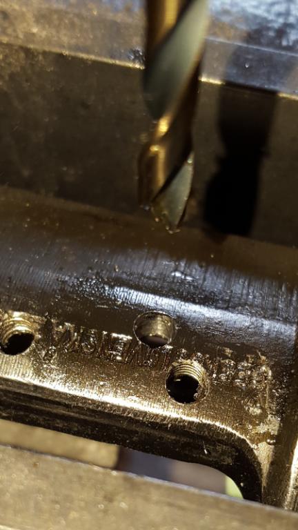

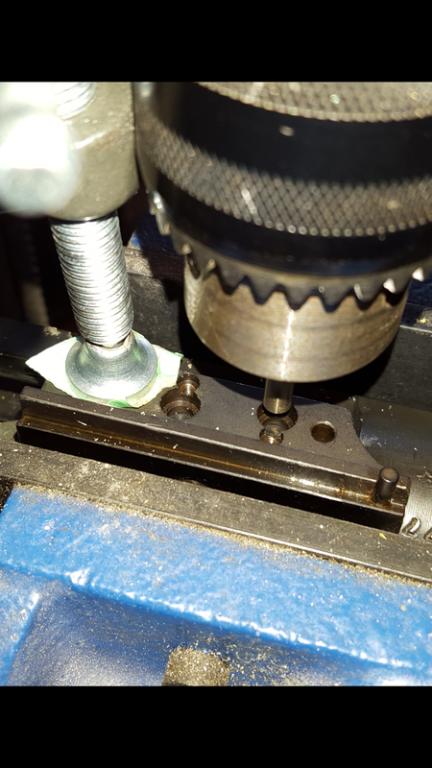

    The setup in a task like this is very time consuming, getting everything level and locked in place to start the first hole took almost an hour.
    Once locked in place, I centered the drill in the first hole.
    Once center, I then removed the mount and cut my first hole with a center drill to get through the case hardening.
    Then drilled, nice & centered
    Tapping was done in the press to ensure a square thread
    Start all over for second and third holes, after they were cut the locating pin holes were drilled.

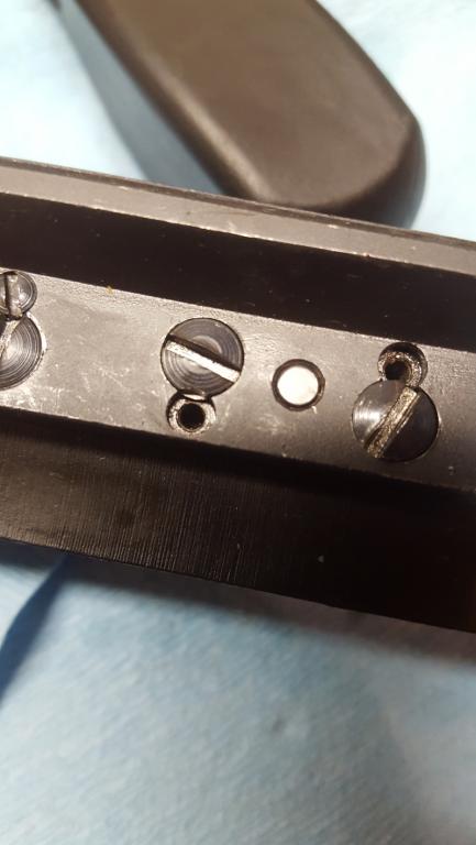

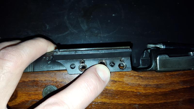

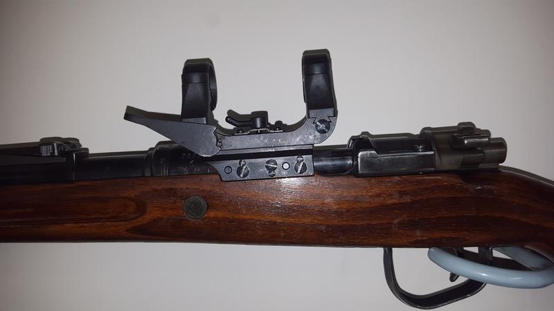

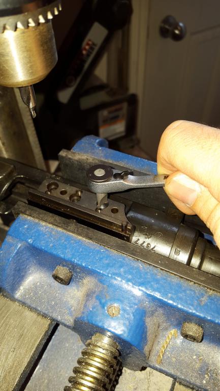

    Once it was all set up, the screw heads need to be notched for the capture screws.
    I know I'm going to get called out on it so I'll admit it! I did open up one of the screw slots a little (sigh), but I'll clean it up when I remove the mount again.
    Being locked under the press, I had no room for a conventional driver and had to use a ratcheting wrench type, so rolling a slot is easy if not perfectly square.

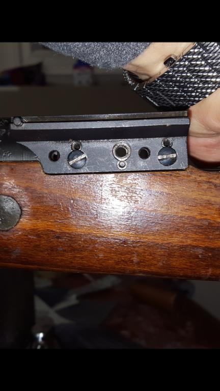

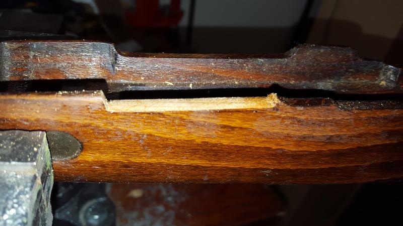

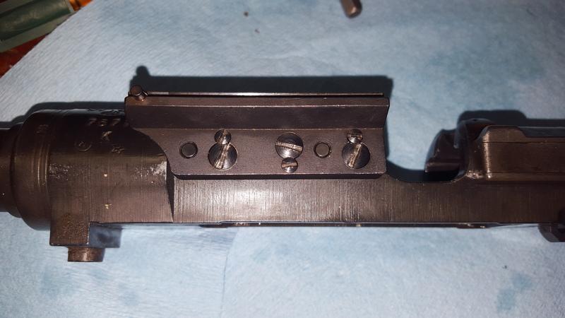

    Now to inlet the stock, note the spacing of the 2nd screw hole in relation to the original its close but not touching, I do still plan to fill the old holes.
    (Picture makes the second hole look out of round, but it isn't.)
    Rough line up
    I started by cutting only half the distance to the line, then filed and sanded CAREFULLY the rest of the way.
    I found this to be the most tedious and nerve racking part as you cant rebuild wood if a cut is too deep
    Snug as a bug : )
    The clearance is even all the way around, the picture makes it look tight at the front and back.

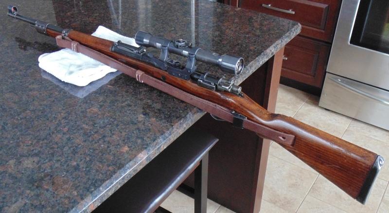

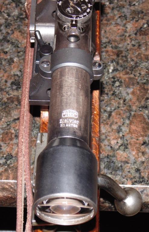

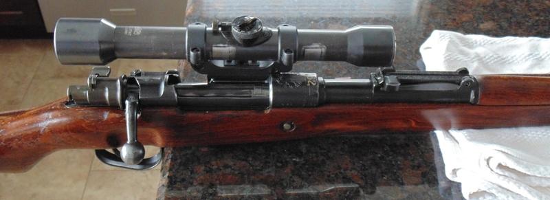

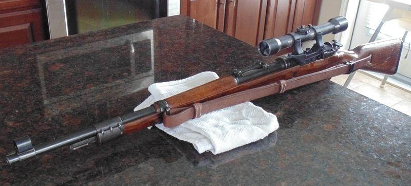

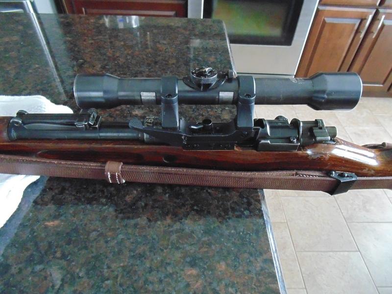

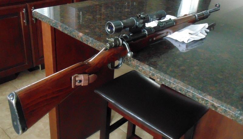

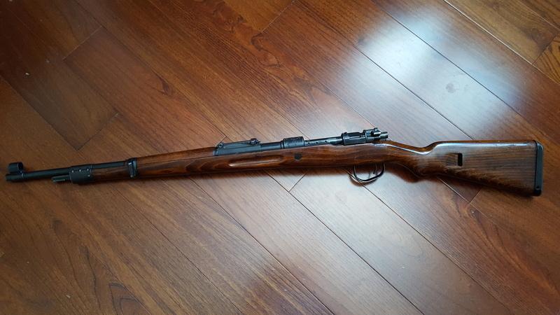

    Half way through the build a legit 1920's Zeiss Jena Zielvier (Actual ZF39!!) came available from a great CGN'er! (Thanks again Corey!)

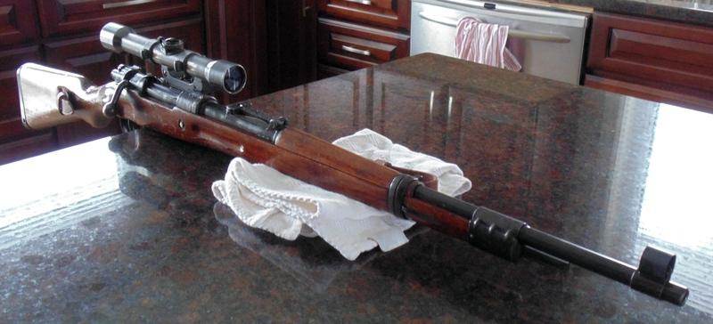

    So, with the help from many fellow great CGNers and a VERY knowledgeable Bob, I have now added a beautiful SSR Sniper to the collection!!

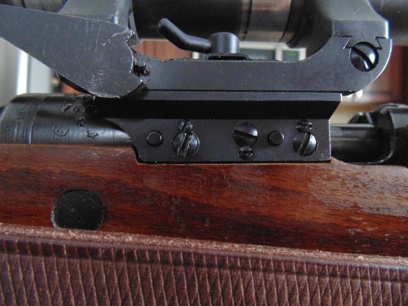

    That front screw slot....

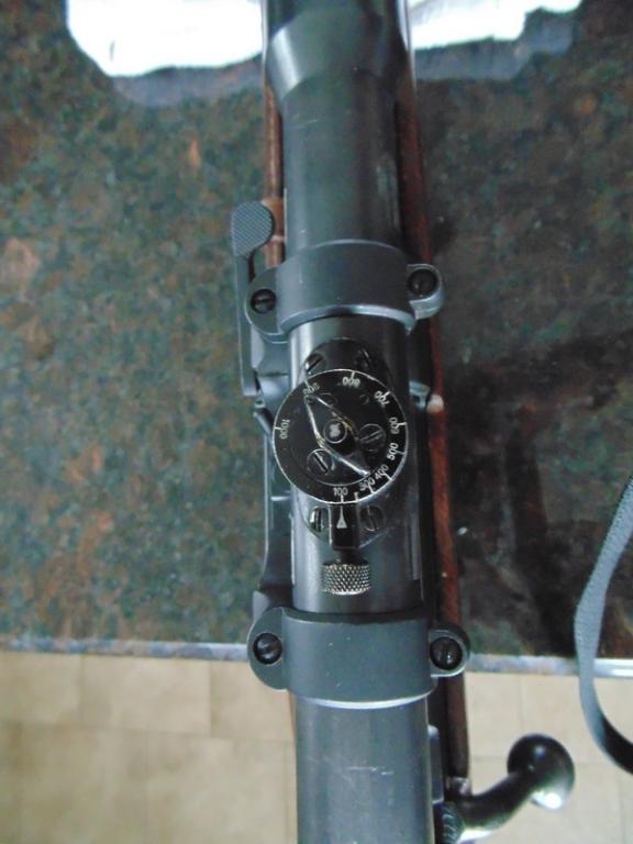

    Nice job. Have you attempted to zero it yet? Interested in how that turns out as I didn't notice any mention of a scope collimation process.

    Quote Originally Posted by vintage hunter View Post
    Thanks!
    After installation, I bore sighted it, without changing the windage on the mount, the scope was only slightly right at 100 and slightly low on the scopes "100" elevation setting. I'm going to leave it as is and see what happens on paper.

    Is that a repro scope? I had one like that and could not get it to be consistent. but mine was chinese. go figure.

    Quote Originally Posted by speckles View Post
    No sir! Not a fake!
    1920s built zeiss

    that will be a great shooter. The pics of your work is fantastic. wish more folks would post work in progress.

    The lack of 'work in progress' posts is exactly what made me do this one. It was very hard to research the process, so I hope this helps someone with their own build.
