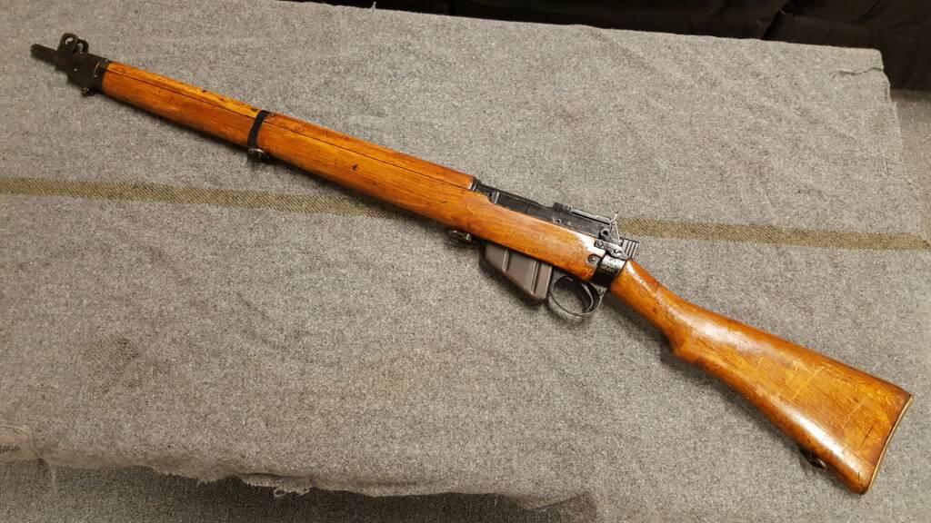

    Getting the topic started with some pictures. Text to follow!

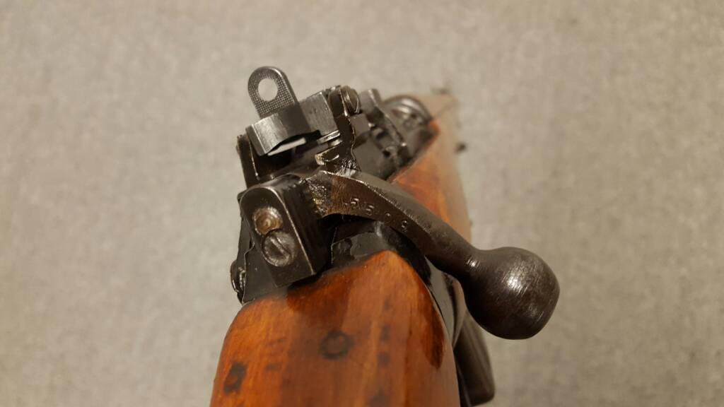

    This is a project rifle of mine, it is a heavily varnished No4 Mk1 that while mostly complete, has seen the bad side of neglect since it was assembled in 1943. The rifle has been drilled and tapped for an unknown scope base and was obtained without a rear sight, ejector screw, and a few stock concerns. The bolt is a mismatch, the magazine spring is broken, but the bore is very good to almost excellent.
    It does headspace properly and shoot, so I intend to practice repair and restoration techniques and see where I end up. It all goes well, I would like to consider an optic mount since the receiver is already slightly hacked up.

    #5 Rear sight is a Canadianicon one from my parts bin, and detail of the bold handle.
    #6
    #7 Bolt body is marked N S H and an understruck 3 or 8, anyone know what this indicates?
    #8

    #10 Notice the split in the wood, hopefully this is something that can be repaired, as this stock does match the serial of the action.
    #11 The action cover loop has been broken off at some point to clear the "sniper" sling swivel which has been donated to Seaspirter's Long Branch build. Brian Dickicon has a regular guard screw replacement on the way to fill this hole.

    You can fill those holes you know. They'll be blind after. Or, a TO-1 scope mount and an older Weaver would look about right. You can make a cheek piece out of walnut square stock.
    I think that’s pretty common. Someone didn’t know what they were doing when they removed the forearm. Ask me how I know… I just glued it back on because I have no woodworking skills. Real armouers no doubt have a proper fix.

    The filled-in holes in the wrist of the butt show me that a REAL Armourer has patched it in the past. Patch undercut or dovetailed, glued and then pegged with oak dowels. The cracked fore-end at the rear of the trigger guard was a common break point that is another easy patch and peg fix.
    The holes could be welded over BUT.......... If you do, you will never remove the barrel again as the weld WILL adhere to the barrel set inside the breech ring. The only way is to remove the barrel, slightly countersink the holes, clamp a copper plate underneath and then mig over.
    I had been thinking about the "way forward" with this rifle and given the uselessness of modern repro No.32 scopes, I have been thinking on a vintage weaver an early K series or maybe a Lyman Alaskan. I could use a TO-1 mount I suppose, never thought of that option.
    About filling those tapped holes...
    I had been looking at methods to fill the holes, and had not considered using a MIG welder. I do have a good one, but am not at all sure where on the scale I should be for heat for this sort of project any ideas?. I would remove the barrel as directed and weld to fill the voids.
    The other option is the soften a matching screw, thread into the hole, saw off near flush, peen, and blend with files and sand paper. But there are appearance drawbacks to that method as well.
    I do appreciate everyone's answers, and I am not jumping into this work right away so there will be plenty of time to discuss, plan, and practice.
    Fitting an optic is still an on the fence item for this build, but the foremost hole would have to have a screw extracted from it, there is a bit of a broken piece lodged in there.
    My first order is to tackle the low hanging fruit, complete disassemble, and stock repair, then refinishing.
