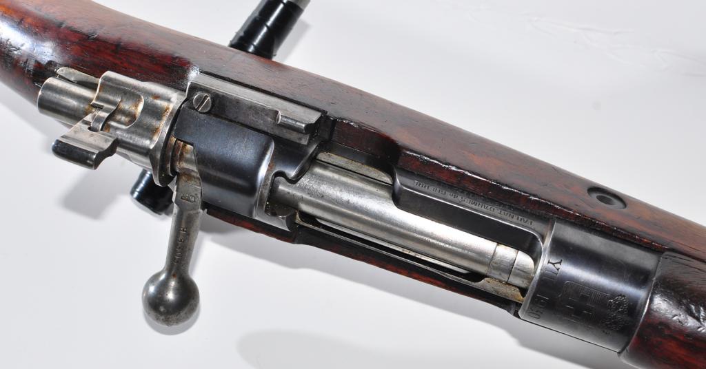

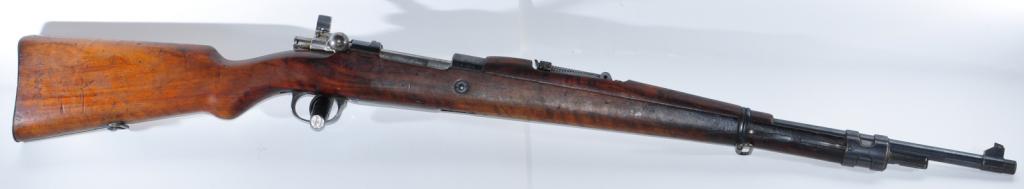

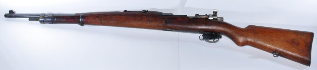

    So I've been in the market to add another Mauser to the roster for awhile since my G29/40 is a mixmaster and a bit tired and my Geha 12 gauge is an oddball I don't really shoot anyway. I was tempted to order a matching M48 but am not in the mood to clean cosmolineicon in the middle of winter, while a Type 24 is a huge risk in terms of being able to recover it as most were beat hard. So when I found this 1930 Greek FN Mauser at a local auction, I reviewed it carefully, tried to educate myself a little on it before bidding, and wound up winning the bid for far below a price where I'd have to think about it.

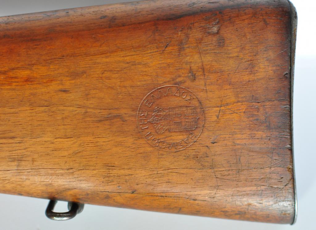

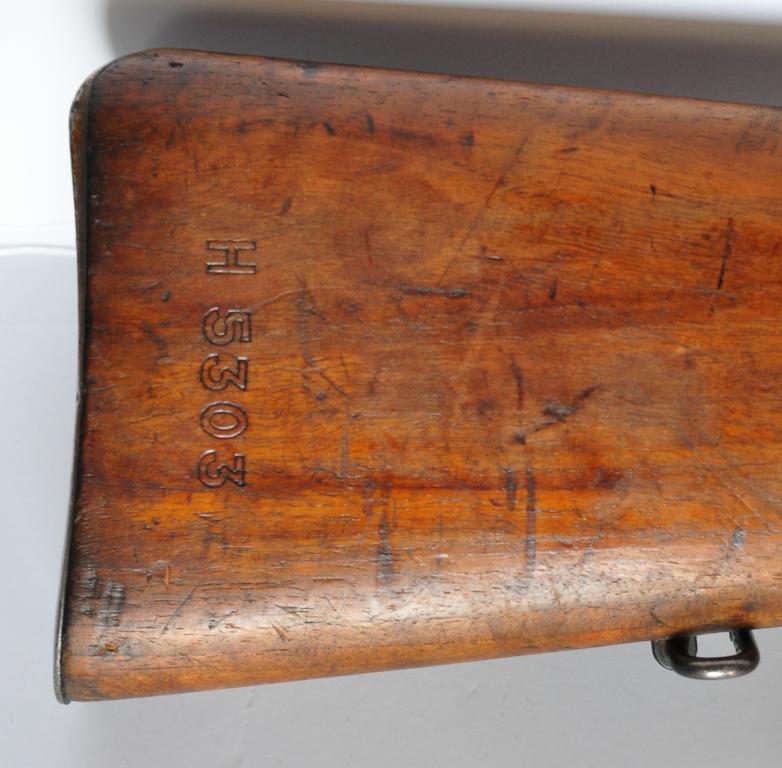

    The serial number on the receiver matches the bolt and stock, could not find it anywhere else on the gun, but I understand that most parts should have an A on them. This showed up everywhere I checked except the trigger guard, rear band, bolt release arm/stop, and buttplate (which is very rough, it may be obliterated). Any thoughts on this and where I should look for them, or if they had them? It was present on the front band, front sight, bayonet lug, rear sight, safety, bolt sleeve, cocking piece, and bolt handle, not had it apart yet. Most of what looks like rust is actually just old grease that should clean up no problem. I can also not find any import marks on it. Bore seems to be pretty nice without major pitting or any damage to the crown. The crest behind the receiver is there as well but hard to make out.
    On the bad side it came with no sling or cleaning rod, the bayonet was a mismatched 1939 German K98kicon with frog, and there is small, about 3/8", small crack behind the rear of the receiver in the stock. I paid $261 out the door on the gun, which I think is okay? I saw one go for $1100 on Gunbroker but I don't know what it's story is, most of them seemed to be around $400 no sales. Plan is to keep the bayonet and sell the rough Czechicon one I have now instead but that should make me back a few bucks on that one. I also noticed Ball's book didn't have much on these, so any other sources for information?

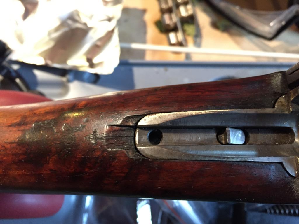

    That's about in line with my book by Peterson which has a 9 year old copy right. I actually couldn't find it at first until you pointed me to the Germanicon section, I looked in Belgiumicon and for a non existent Greece section. So I feel pretty good about it. Of note is how there are some gouges/scratches in the side of the stock that cross over onto the handguard in one or two spots, confirming to me that the handguard is correct to that stock too, or at least they saw action at the same time.
    In addition, the crack is hard to picture... but it's a tiny one I've circled in photoshop. The color balance is a bit wonky here but it makes it a little more obvious what is grease and what are tiny rust spots too, but overall it's barely noticeable in person both the crack and rust spots.

    Crack is a danger sign for the stock!
    Cipherk98, the tiny crack may suddenly grow into a serious one. It is the start of the "traditional" Mauser split caused by the tang being rammed back into the stock. The recoil thrust is supposed to be taken up by the recoil cross-bolt shown in your previous post below the receiver ring. A correctly set-up Mauser stock should thus have a visible clearance behind the tang. Over decades wood shrinks and the wood behind the recoil bolt is slightly battered. This allows the recoil load to push the tang back into the stock, acting like a blunt wedge and causing the split.
    See post no. 6 in this thread:
    https://www.milsurps.com/showthread....ghlight=recoil
    From my own dismal experience I can assure you that the crack can develop very quickly. To avoid this, insert a metal shim (about 0.02") between the recoil lug on the bottom of the receiver and the recoil bolt. And scrape out the cutout behind the tang so that there is about 0.5mm / 0.02" clearance to the rear between the metal and the wood.

    I figured as much... I failed to check this clearance properly when I dropped my G29/40 into a mystery WWII stock and it cracked it 20 rounds later, made worse there as it was a laminate. In that case I put a dowel at the end of the crack to stop it and filled what was cracked with glue, worked it in, and clamped it. Held up fine so far but it's not a pretty repair as it was not a pretty gun. For this gun I'd like it to be nicer.
    Now there is a gouge right where the crack stops and above the stamp; maybe it helped stop it from spreading further? If I make sure there is proper clearance will the crack continue to be an issue to where I'll need to drill the end and put a dowel in, or would I be alright injecting in glue via a syringe and clamping if the clearance is right? I used some aluminum foil to a thickness of about .0268 to test fit a shim; I think I'll need to dig through my scrap pile and make one as I doubt the foil will hold up even after compressing it before fitting, but it left me with this much of a gap which looks alright, if even a bit generous:
    No sanding yet, just trying to see how much it looks. If I do need to touch up this fit after putting in a shim a little 200-300 grit sanding on the inside part where the receiver fits shouldn't hurt right?

    Solved the mystery of the circle A myself, apparently an FN inspection stamp, though it seems the Circle A variant may be unique to the Greek models. The letter that changed was the H prefix in the serial which seems to indicate the series, in this case 7th (H being the 7th letter in the Greek alphabet) if what I gathered was correct. If so it would be one of the last that made it to Greece if it made it that far... I've seen a few in the H8xxx and H9xxx range that showed signs of having been taken and reissued to the Germans. I also assume that the 1930 is only the model number then, not the year of production if that is the case. I feel like learning the fine details of a rifle and it's history, good or bad, once it's in your hands is as fun as shooting it.

    Got the gun reassembled on Monday. The bluing is still pretty good aside from expected wear spots like around the front band and where the hand guard snaps in. A light coat of oil get it nice and shiny again. The old grease cleaned up pretty well with a little Hoppes and a paper towel, or for the tough spots mineral spirits and a very gentle use of a brass brush. The touch of cosmetic rust where the front band was in contact with the barrel, likely where some water got trapped between the two, cleaned up fine. I am still looking for ideas though on what to do to help maintain the finish of the stock and protect it, so any suggestions would be appreciated.
    As for shimming it, I ultimately had to use about a tightly wrapped .010" piece aluminum foil shim, as anything more than that moved the receiver too far forward for the front action screw to thread properly. To account for this I gently swiped the inside of the stock near the rear of the receiver with some 150 grit to get a little extra clearance. From there I cleaned out the bore, lubed up the bolt, and today, took it out for an action check. Ultimately shot out around 50 yards to see how it would do, not knowing how far it was off and facing pretty nasty winds today.
