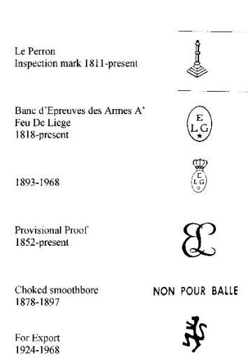

    This is a .270 purchased ~29 years ago. There is no manufacturer stamp anywhere, just numbers and what appear to be proof marks. Does anyone have any ideas, based on the pictures? Do the proof marks tell anything?
    The number pattern on the barrel & receiver is: xxxx . xx .
    Attachment 71646Attachment 71647Attachment 71648Attachment 71649

    Looks like the "Prancing cat" style of mark from Belgiumicon:
    ---------- Post added at 02:17 PM ---------- Previous post was at 02:14 PM ----------
    Could also have P.V. in subscript beneath the wood line of the stock.
    - Darren

    Quote Originally Posted by Sentryduty View Post
    But it's not. It's the post-1931 Czechicon proofmark for rifled barrels. The twin tail of the "cat" is distinctive.
    The Czechs made plenty of Mauser 98 systems in 7x57, a much more likely original caliber in Europe than .270, so a careful measurement of bore diameter and chamber dimensions would be advisable. Of course, it may have been rebarreled/rechambered to .270, but it wouldn't hurt to check. - Think of the 6.5 Carcanos that were rechambered and marketed as 6.5 Mannlicher-Schönauer.

    Quote Originally Posted by kavallon View Post
    Please post better photos of the numbers and any other markings. The caliber should be marked somewhere on the barrel.
