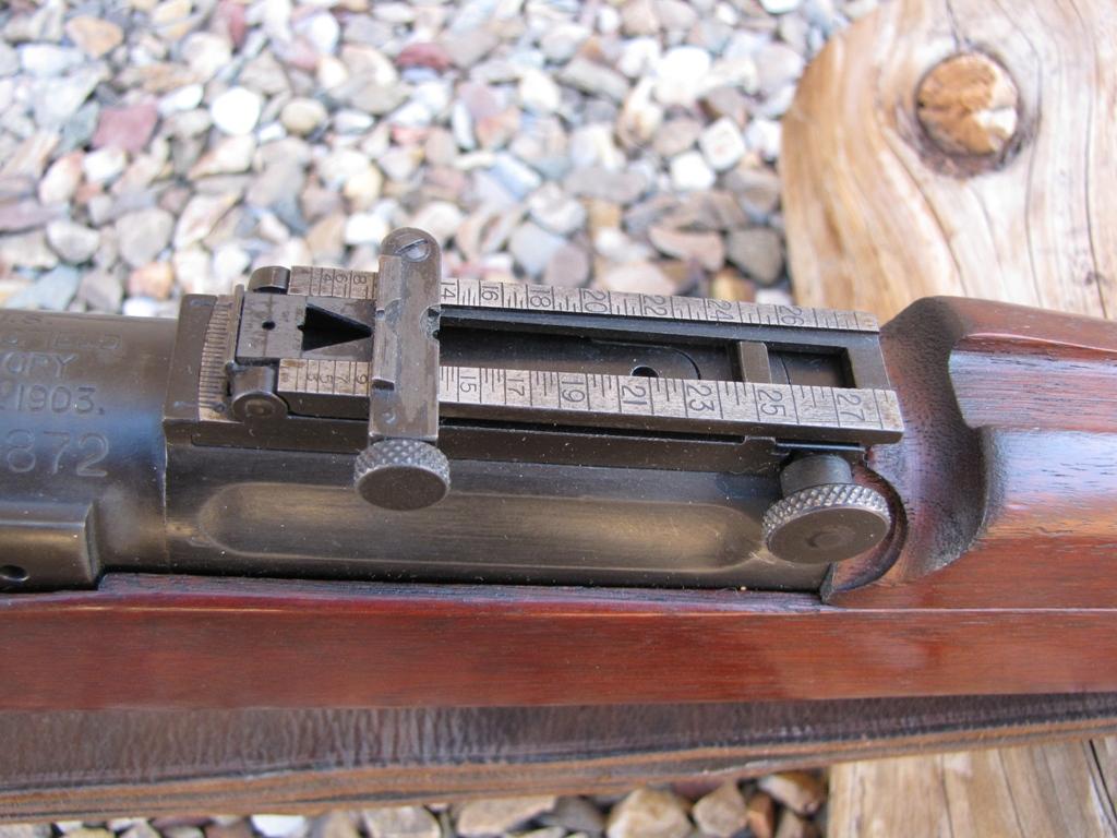

    Steven, asphaltum was a form of black paint applied to 1903 rear sight bases, and the **barreled-receivers external surfaces (**I believe).
    Evidence of it here:

    I have a Marine team Manual from 1935 and they talk about blackening the whole rear sight, the front sight, and the top of the barrel to reduce glare. Then they say to wipe the face of the ladder sight, so it only would leave the lines of the ladder in the black so it would be easy to read. That is why all the snipers have the earlier bright faced sights put on them.
    I just figured they used those smudge pots or whatever to blacken them. And I've always taken that stuff to be just built up carbon from being done over and over. But I guess it could be some kind of sight black paint as well. All the rear sights on the snipers show that black crusty stuff. Heck my sniper has a white looking paint on the front sight, probably to contrast against a black bullseye.
    But I will have to go back and read that manual again on that, maybe I missed exactly what they used. But I think it just says to "blacken" them. And I guess it probably was a lot of shooter preference on that too.

    I just went back and read the team manual. They used gasoline to clean the grease off the rear sight and front sight, and then used smoke to blacken them. Then wiped the face. This sort of fits the rifles I've seen as I thought it looked more like carbon.
    But I wouldn't rule out shooter preference in this equation at all.
    I've seen mention of sight black digging around back then, but just never heard of the term asphaltum. I will have to keep an eye out for that.
