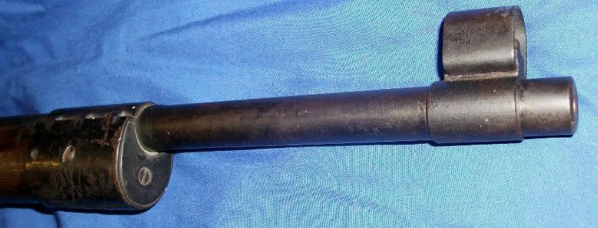

    Would appreciate any analysis, dating and/or valuation concerning the Mauser. I realize it was manufactured at Orbendorf in 1945, but how late in the war? It shows a lot of corners were cut in the manufacturing at this time. It came with a narrow web sling that looks like a wartime field improvisation. The bore has strong lands and grooves with frosting/patina(?) but no visible pits.

    By ser nr your 98 was made in Jan 45, just before Oberndorff changed their code to svw.
    The sling is correkt for your rifle. It is an odd ball and fairly rare. Are there any markings on it - would be an ink stamp?

    The bayonet lug/front cap are missing too...wonder how/why that happened. The pin has to be driven out so it wasn't an accident. I doubt it's lying about?
    I am by no means a Mauser expert but I thought by the late war period they started to do away with those features on the rifles to speed up production.
    Everything secured by screws.

    I don't see any sign of a front end fitted on the close up pics it's so tough looking, later yes they were a tragedy of a monsterpiece.
    As for the front band and front cap gtodan, I guess it may be a screw hole but still I can't even see the hole for that in the wood.
    The hole is there but the band is out of position in the picture. Can't see any screw striations in any of the three holes on the side and front of the stock.
