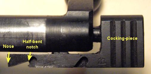

    It may not have been the design intent, but an important function of the "half-bent" notch is to catch the striker assembly should it be released by some action other than the trigger being pulled and held. This most commonly occurs if the safety is not fully "on" and then the trigger pulled, allowing the cocking piece to move forward just off the sear nose - but arrested by the safety's "hook". If safety is then moved "off", striker falls and rifle could discharge inadvertently were it not for the sear then catching in the half-bent notch.
    Attachment 80269
    (Click PIC to Enlarge)
    Last edited by Badger; 02-02-2017 at 08:32 AM. Reason: Fixed image for poster to show in-line with post..

    I see exactly what you\re saying Parashooter........ But cutting to the quick, what you're describing is 'mechanical safety' - exactly why it's there........

    Agree completely, Captain. Just trying to show the youngsters how the "mechanical safety" function can benefit innocent bystanders!
