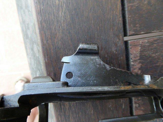

    Your 1940 Lithgowicon with manufactured with cutoff installed and yes there are MA41 marked cutoffs. I've probably got s photo or two somewhere if you want proof.
  15. #10
    Legacy Member ufo8mydog's Avatar
    Jun 2013
    Yesterday @ 11:24 PM
    100
    05-05-2025
    01:49 AM
    Not a very good photo of a 41 dated cutoff
