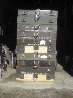

    To that end, I picked up almost 30 chests the other year, and some had been painted grey, most the semigloss green, one black, and a couple were still their original olive. I suppose it depends on what level of "overhaul" the paint job was done at...user, unit, station or depot.
    As to the stencilling, I found a few varieties of the original stencilling, including one chest where they seem to have silkscreened the lettering as there are no gaps like you get on a traditional stencil. The Original did not have much more than the basic description.
    Thru the 50s, they repainted the chests, and you would usually find the checklist "scale" number.
    In the 60s, the paint job included the NSN for the rifle complete with EIS.
    So depending on what time period you are covering, the stenciling will change.
    I'll try and snap some photos of the different markings.

    Canadianicon C No.7 transit chests. No two the same.
