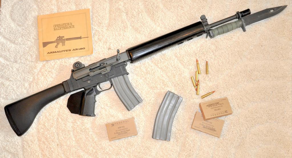

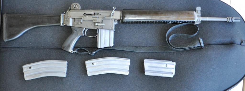

    I had posted in an AR180 thread on another forum, but not here. Also, it was just as Photobucket decided to change and charge $400 a year to do image hosting. Well, now I have Imgur, so we will give it a try.

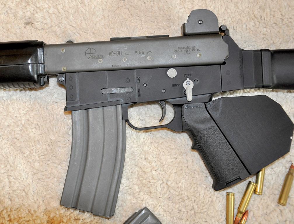

    Backstory, As I was leaving Mississippi in 2011 to return to CA, I had sold my Sterling AR180, because they are banned by name in CA, and are a felony. As I was leaving though, a friend offered me a mint condition Costa Mesa produced AR180 (with 2 factory 20s) for a really stupid low price I could not refuse. I bought it and dropped it at my buddy's place in Elko Nevada, on the way through to CA.

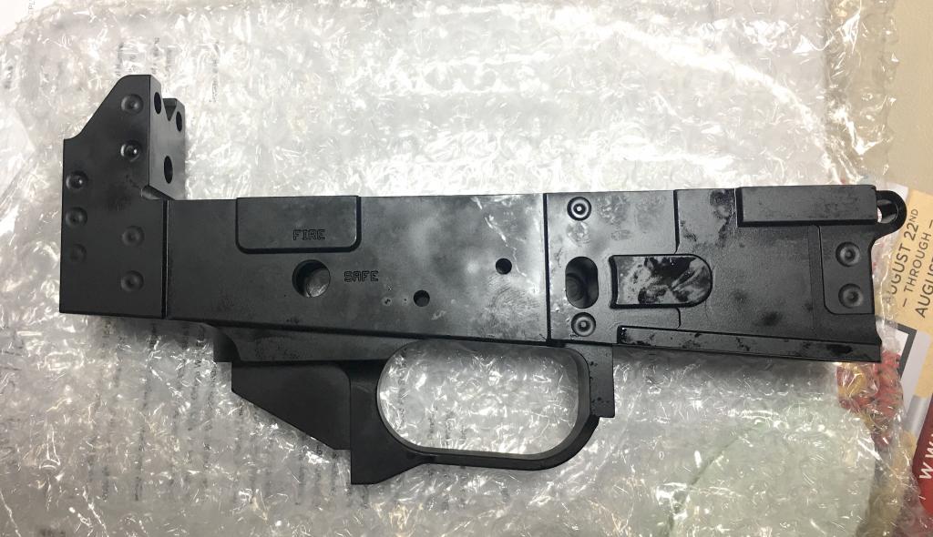

    Fast forward: I would shoot it on the rare occasions that I went to Nevada (about 3 times in 5 years). Anyway, about a year or so ago (maybe more) I decided to get a Nodak Spud AR180 lower, which is "off list" in California, and can be built into a featureless semi auto. Well, I never was able to put together the energy or money, until earlier this year. I had my buddy send me the upper, and I got the lower from Mike and Harlan in June. I rounded up parts from Big Rix and Stormwerks a set out to make an AR180 I could enjoy behind enemy lines: It is California Featureless with a fin grip and muzzle brake.
    And here is the retro beauty.....

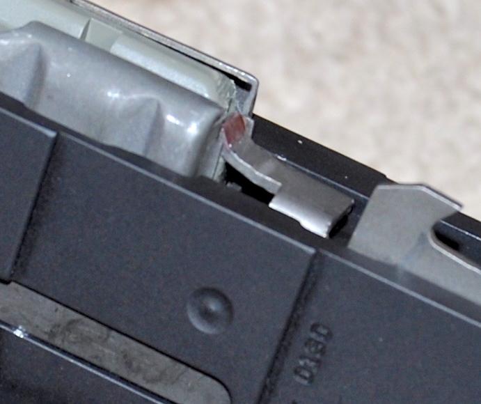

    I had to modify the mag catch of the NDS, because I did not want to modify the mint Costa Mesa upper. The two steel 30s work in either the Costa Mesa lower or the NDS lower now.

    I love surprises! I was digging in some boxes of old gun junk and tactical stuff in long term storage in the garage, and found my two well worn, beat up, 40 round AR180/AR15 factory mags from when I had my first Sterling AR180 as an LEO trunk weapon in the 1980s. I had two factory 20s, two Sterling factory 30s, and the two aftermarket 40s. The 40s were "no-names", and did not work reliably. I stuffed them away with some old gear tactical gear from back in the day, figuring two 20s and two 30s were enough. I had totally forgot about them in the ensuing years, as I had pretty much written them off as junk back then.
    I was a bit dismayed, as they had gotten some surface rust pitting on the outsides from being stored for 30 years. First thing I did (after cleaning the rust off nd oiling them up) was to replace the springs with Chrome Silcon replacement springs, and the followers with Magpul Gen IIs. The followers I took out were like early plastic 20 round followers. No wonder they wouldn't feed from a full mag. Anyway, since they also fit AR15s, I'll try them and see if they work any better now. I may just ship them off to my buddy in Nevada to put with the AR180 lower half, or I may just keep them here.
    Here they are in my "Featureless" NDS18S build. They look cooler in the the Costa Mesa, though.
