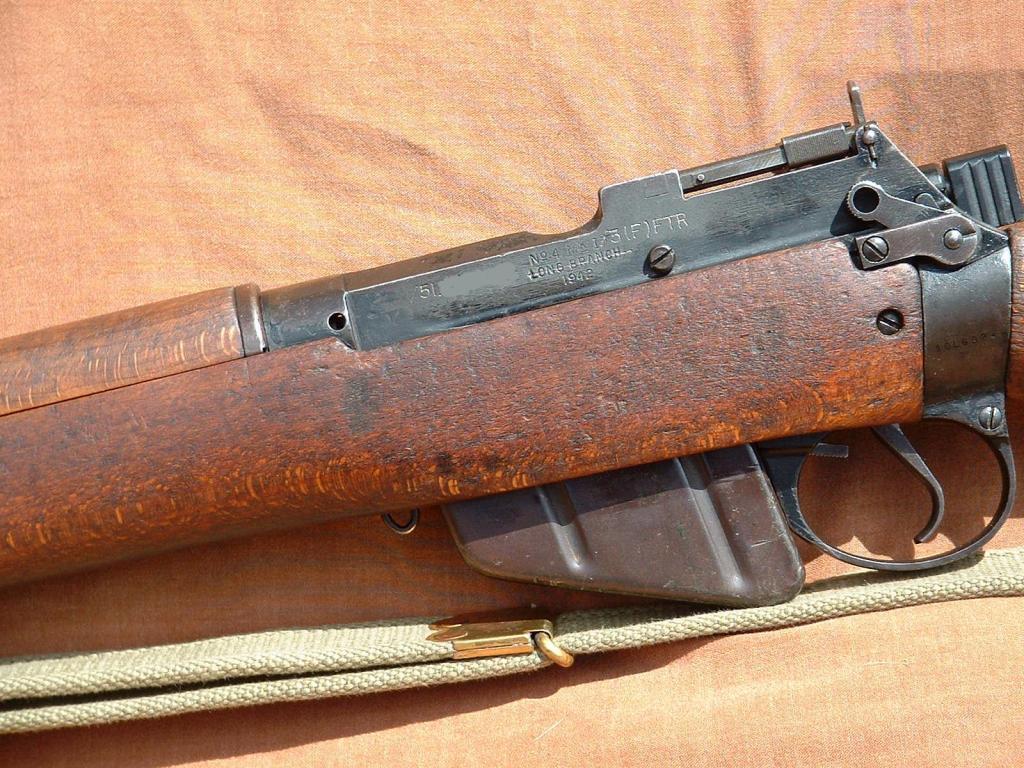

    5L 1942
    MJ, don't take this personally, but that's crap.

    MJ, would the sight be replaced when FTR'd to No4Mk1/3 spec ?
    Apr 2008
    05-01-2025 @ 12:52 PM
    Edgefield, SC USA
    4,116
    05-04-2025
    11:55 AM
    I'd say definitely.
    Legacy Member MJ1's Avatar
    Sep 2007
    08-26-2024 @ 04:52 PM
    Guanacaste
    739
    05-04-2025
    08:55 AM
    Quote Originally Posted by 30Three View Post
    Very likely so.
