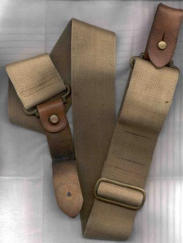

    Most civilian users purchased a wider sling from Parker-Hale like this:
    There were several varieties of these. Some were made from converted Lewis Gun slings. Similar ones are still available, though made from nylon and plastic these days.
