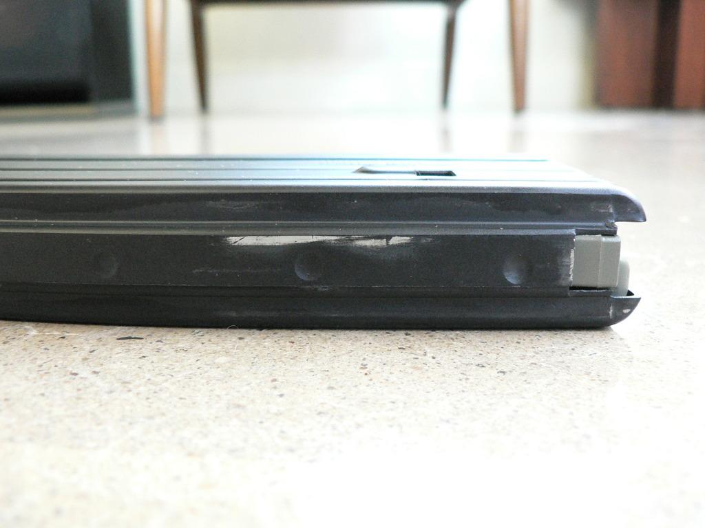

    Here's the front of the OKAY Industries magazine after a few insertions:
    And the rear spine:
    The finish is already worn down to the metal.

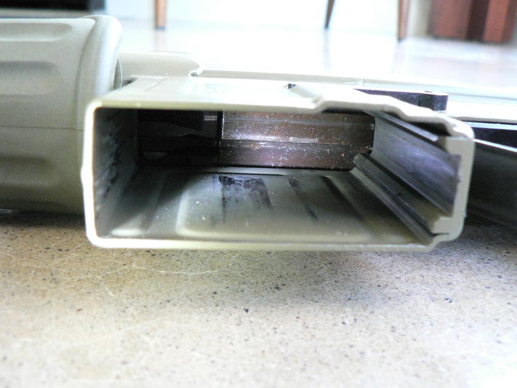

    Here are a few view into the magazine well of the MCM after trying out all the magazines:
    And the magazine well of the HMG after a whole lot more magazine insertions:
    Notice that, while both show rubbing, especially along the front surface, the MCM one shows a lot more overall black marks from rubbing the finish off the magazines whereas the HMG shows more wear to it's own finish. Also, there seemed to be no rhyme or reason to what would and what would not fit into the MCM well. For example, two of the Center Industries magazines fit while two would not. Some of the Colt magazines fit while others would not. Three of the steel ones fit while five did not. The fact is that the MCM rifle has a substantially tighter magazine well than the HMG offering. The good thing is, OKAY Industries magazines are cheap and readily available. Besides, this is a range toy, not something you are going to take into combat and MCM recommends that you use the OKAY magazines anyways. So just buy yourself a few and forget about it. That should eliminate any problems regarding magazine fitment and save you a lot of potential frustration.

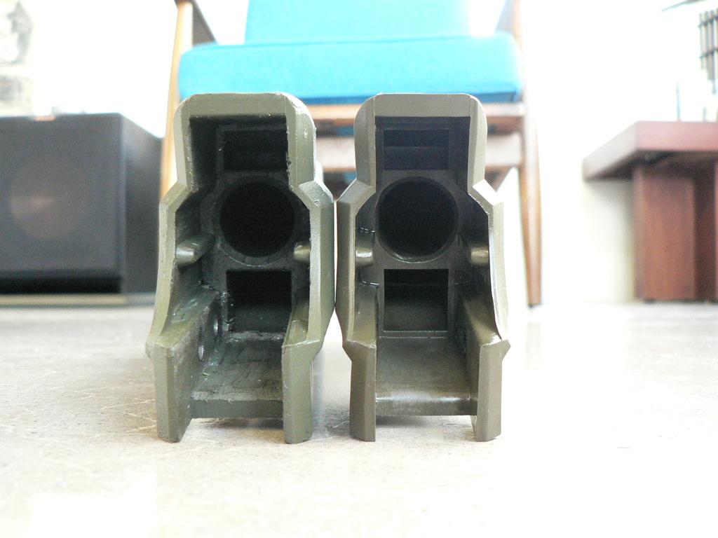

    Here, are looking into the front of the stocks with the MCM on the right:
    Again, everything is perfectly reproduced.

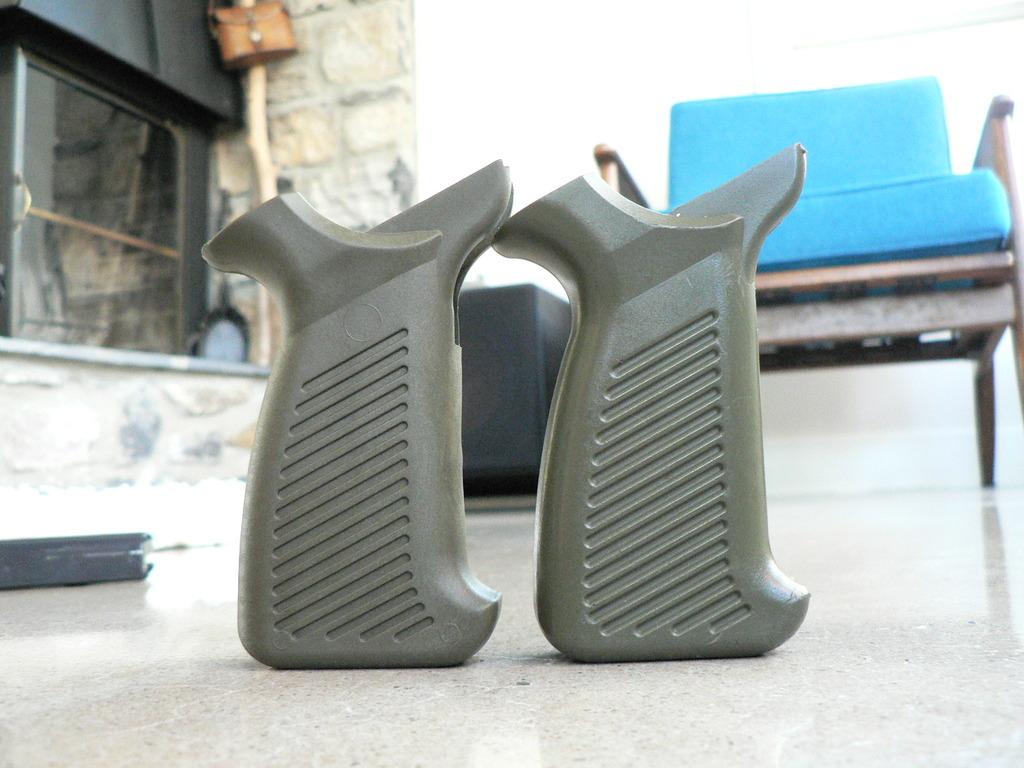

    The last piece of furniture we need to look at is the pistol grip. As with the rest of the polymer parts, they did a fantastic job and only real sticklers for detail will notice any differences between the MCM made part and an original.
    First up is the left side. MCM part is on the left:
    The raised ribs between the grooves are slightly rounded on the original while they are flat on the reproduction. Also notice that the original has a mold ejection pin mark starting in the fourth groove down, running over the fourth rib and into the fifth groove while the MCM has no such mark.
    Right side:
    The MCM grip has two ejector pin marks, one large one above the grooves and one small one at the bottom front. The original has no such marks.
    Looking down into the top of the grips, we see that they are pretty much identical. MCM is still on the left:
    Front of grip. MCM is on top:
    Both show a mark in approximately the same place where they were removed from the sprue.
    Bottom and bottom/rear 3/4 view of grips with MCM on top:
    Mold lines differ somewhat between the two but all of the contours are dead on.

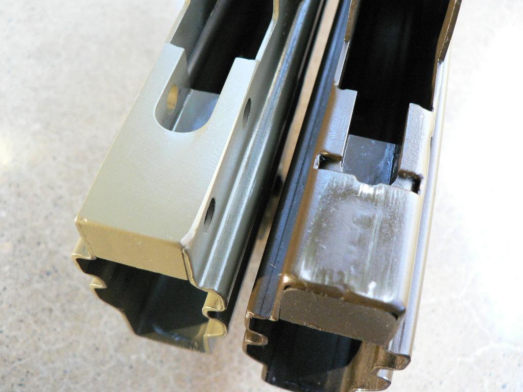

    The right side is where we see just how much both boxes deviate from the original design:
    How? We will consider each one separately in a moment. But before we do, notice that, other than the aesthetic condition, there is one obvious difference between the boxes. Notice that the empty hole where the fire selector axle fits is smaller on the MCM box. This was done so that a full auto selector switch will not fit into the box. We'll look at the MCM modified selector lever in a bit. Another thing I want to bring to your attention are the two tabs, one sticking out the front of both boxes and another at the rear, with holes in them. These holes are where retaining pins pass through the receiver to hold the box in place. The rear pin also passes through the front bushing in the butt stock.
    First, is the HMG box close up:
    If you look at the top edge of the box, you will see that it steps down starting slightly forward of the trigger pin and continues all the way to the front of the box. This was done by HMG to create clearance for a blocker bar that was welded up inside the receiver.
    Here is a picture of the blocking bar:
    We are looking up into the bottom of the receiver. To the left is the rear of the magazine well. The spring we see to the left provides tension for the magazine release mechanism while the spring seen on the right is the tensioner for the bolt hold open device. The blocking bar is in the middle of the photo. If you were to try and fit a select fire box up into the receiver, it would hit this bar and stop. The step HMG cut into their semi-auto only box allows it to seat without hitting the blocking bar. Got it?? I hope so. While we're looking at this picture, I want to point out a design detail; one that is part of the original rifle as designed by CETME. Notice that the area where the fire control box retaining pin and magazine release bar passes through the receiver is strengthened with additional metal for durability. If additional steel had not been added in this area, it wouldn't hold up to use for very long. In fact, the entire rear of the magazine well is a milled block welded in place and these strengtheners are part of that block. A lot more goes into the design and production of origami firearms than meets the eye. I love little details like these.

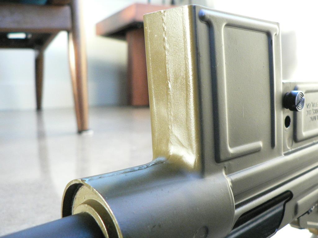

    MCM did essentially the same thing but went about it a different way. Here is a closeup of the front right side of their fire control box:
    Notice that, instead of milling away part of the top edge, they milled away part of the entire front side of the box.
    And here is the corresponding area within the receiver:
    Instead of a bar, MCM chose extend the milled strengthener block toward the rear of the receiver thus creating what I call a "restrictor plate" because it restricts an unmodified select fire control box rom fitting into the receiver. In addition, it (in theory) does double duty as an aide in reassembly of the rifle. The idea is that there is supposed to be a precision fit between the restrictor plate and the corresponding cutout in the fire control box. When they are fit together, the holes in the receiver and the hole in the box should align perfectly so that the retaining pin pops right through. I say "in theory" above because it doesn't quite work out all the time with my rifle. It's close and sometime the retaining pin presses right through the holes and seats perfectly. But sometimes, it just ain't going for love nor money. Then, you have to remove the pin and wiggle things around a bit before reinserting the pin. With enough fidgeting, it goes together. Whatever you do though, DO NOT beat on the retaining pin if it doesn't easily slide through. It's not designed to be beat on and you WILL screw up your rifle sooner rather than later. You have been warned!
    To be fair, my rifle is new and clearly pretty tight. I expect things to loosen up with use and maybe this issue will correct itself as things wear in. Whatever the case, it is far less fidgety to reassemble than the HMG design but some amount of frustration is always going to be there. It's just an artifact of the original CETME design. When you buy an AMG, you just have to embrace the fidget...….no matter who made it!

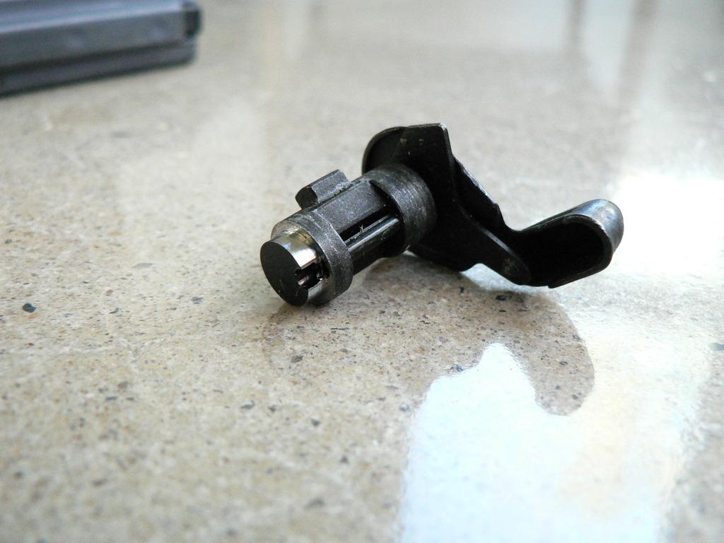

    Theirs appears to be modified in two ways. First, was the addition of a pin running parallel to the axle shaft. I assume this was done so that it will not interact with full automatic parts should they be fitted to the fire control box. The second modification was turning down the circumference at the end of the axle where it fits into the right side of the box. This precludes fitting of an unmodified full auto selector switch into the box.
    This last picture of the night shows the two selector levers side by side for easier comparison. MCM is on the left:

    Here, we see a comparison of the welds on the two rifles. To be specific, we are looking at the weld where the cocking handle meets the front of the receiver. The MCM is at the top:
    Notice that the HMG has a better weld here. Not only is the MCM weld aesthetically inferior, but it also shows an ugly void. I'm sure it's plenty strong but it is unsightly. In fact, it's the most unsightly weld on the entire rifle. While we are on the subject of welds, let me say that, in my opinion, the rifles are equal. In some places the HMG is better while in others the MCM is the winner. I'm not going to call out each and every detail but I am going to show the same areas on each rifle so that you can make up your own mind about who has done the better job. I will say that I think both exhibit sufficiently strong welds and I have no worries about failure on either rifle.

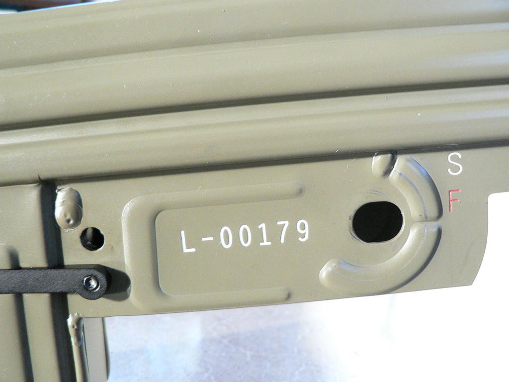

    Serial number and selector markings:
    The HMG markings were not filled in when it was new. I did that but they are so shallow that it took me several tries to get even the marginal quality shown here. Fortunately, the pathetic paint job is not so obvious in hand because the letters are much smaller in the flesh. There is no such problem on the MCM. In fact, it's no problem at all since it came that way. Yay!
    Magazine well, left side:
    The MCM marking are again far superior to the HMG ones. MCM even stamped it "5,56" just as it should be.

    Weld along front of magazine well:
    Again, I have purposely placed a glare on the weld to accentuate it. While the HMG looks cleaner, the more pronounced weld on the MCM looks more like what I have seen in pictures of an original. Notice the little defect at the bottom corner of the MCM magazine well right where the front turns to become the side. This is steel, not a defect in the cerakote and it is sharp; sharp enough that you can easily cut yourself on it. Mr. Bane, if you're reading this, check the bottom edge of your magazine wells just closer before sending them to the paint shop and dress them if necessary. Thank you sir.
