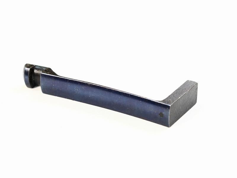

    If the rod is only going in a couple of inches it is probably hitting the front band spring. There should be a hole in both band springs for the rod to pass through. These sometimes get replaced with springs that do not have the hole, so the rod will not be able to pass through. If your spring does not have the hole you could swap it out or drill a hole for the rod to pass through. Other possibility is the band spring is not completely seated or the rod is bent slightly and hitting the edge of the hole. You may need to enlarge the hole or try turning the rod when seating it. I'd take the band springs out and check them as a first step. It is a good idea to strip down a new-to-you 96 anyhow including taking the barrel out of the stock to check for rust, grease, etc.. Very easy to do. No gunsmith required.
    Band spring with no hole for cleaning rod for use on M/94 carbine:
    Correct band spring with hole for the M96:
