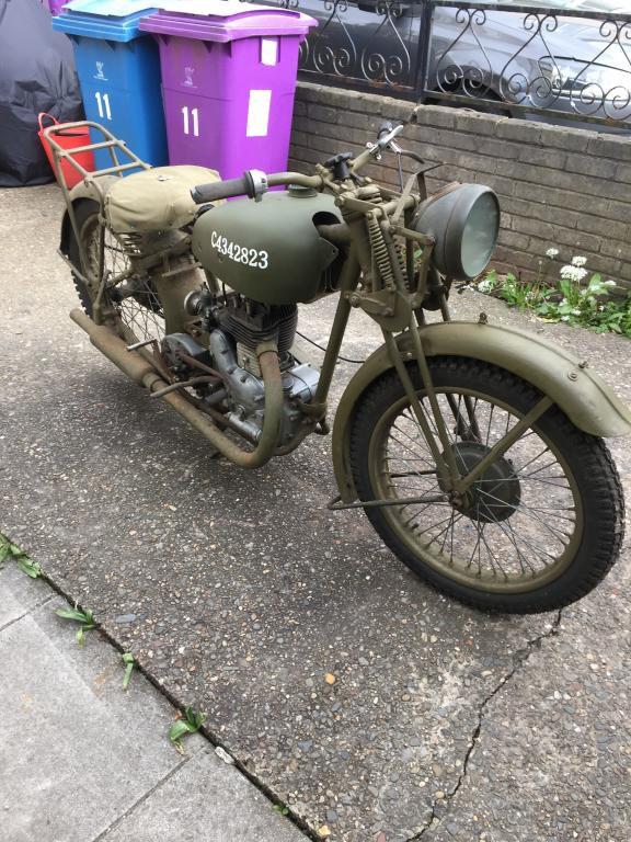

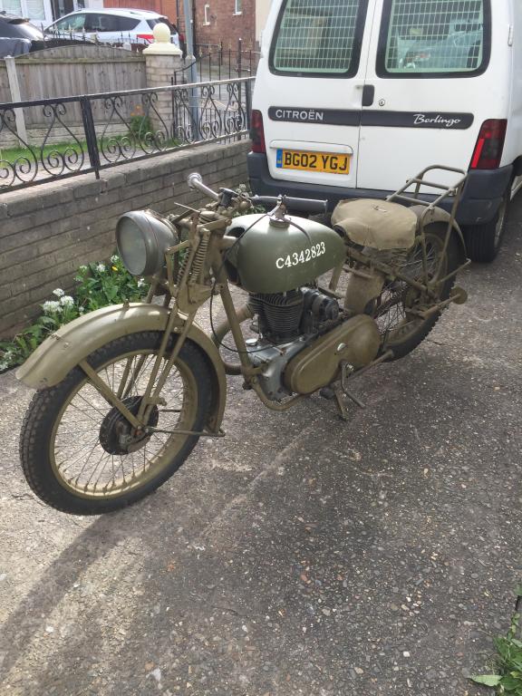

    Something I never intended to buy and wasn't even looking for, as I was looking for a new Royal Enfield cafe racer, I say new as the ones I was looking at are now being replaced by a newer model, but the ones still left in the dealers are offered at around £4000 on the road..... nice bike for what you get.

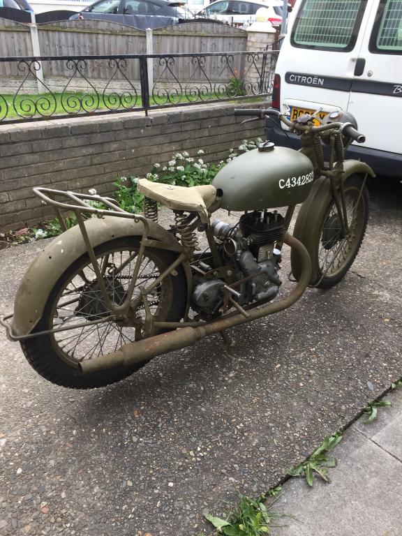

    Anyway whilst looking on ebay an advert caught my eye, it was a Royal Enfield WD/C, not a complete bike but I had a think and contacted the seller......... made an offer and a deal was done.
    It turned out the location was not far from Holts Auctioneers, very handy as I did a deal on some unsold lots and my FAC renewal had come through with my variations.
    I dont intend doing much on the Enfield as yet, just sourcing the missing bits etc and to get it running, it has WD/CO crankcases with a WD/C cylinder head, so someone has made a Side valve engine out of a OHV engine. It was registered and it has been running at some point.
    The previous owner passed away, but had started doing some small jobs on it, one was the petrol tank, which was sold as the Bike was in a separate storage so not known about until the V5 was discovered, I gather other bits may of been taken off at the same time ......

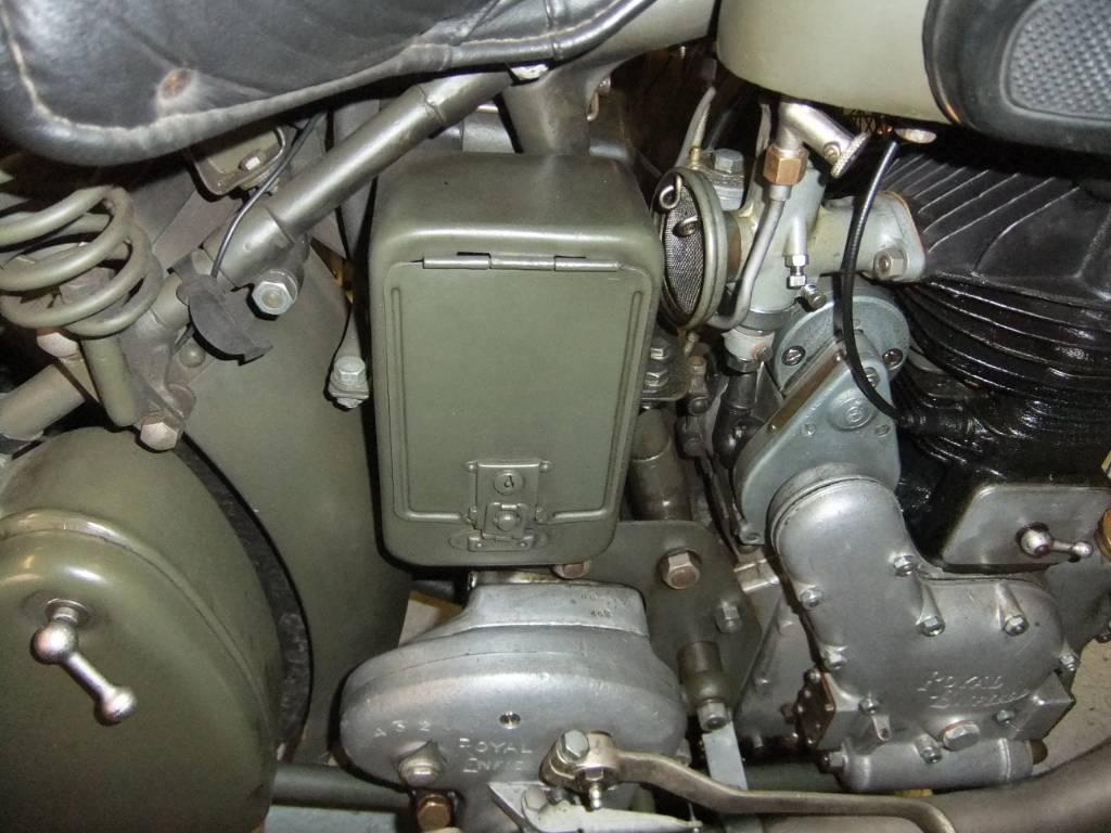

    This RE need toolbox like this?

    Thanks Luis, Its a WD/C but has a miss match of parts, the tool box is on order.......got it started yesterday but the clutch give up after so many starts, the clutch centre/ spider was badly worn on the splines, looks like its come loose a few times from the main shaft, at least I spotted it now rather than later.
    So will try and track one down tomorrow but won't hold my breath, need to find out what box I have as I just found out the C and CO had different box's, the main shaft on the C is smaller diameter than the CO..... all part of the fun of WD Bikes is hunting down the parts.

    Post WW2 my father owned an ex WD Royal Enfield bike and when he eventually decided to sell it he found that no one wanted it and so he broke it up for spare parts. Unfortortuniately there wasn't much interest for the spare parts (1950's) either but as my father didn't like throwing anything away he retained the spares that he couldn't sell and even took them with him, several times, when he moved home. The very last spare part from this bike which I personally had the honour of selling, in the 1980's, was a "triangular" toolbox and it wasn't only distinctive in it's shape but it also had a special document holder on the inside of the cover. I remember the chap who purchased it being very pleased that he had found this missing toolbox to complete his restored WD Royal Enfield. The impression that I got was that these triangular toolboxes with the document holder on the inside of the cover are not that common.

    F10, yep the the triangle toolbox is rare item but not as much as the square one which was only for a WD/C many fitted to the WD/CO but not correct for this bike. the WD/C had a right side fitting tool box the CO had a left one, the right side I think is more rare, saying that I picked up a left hand side one from a car boot sale for 50p .......
    In fact anything for a WD bike is becoming rare but for a RE WD/C some bits are like hens teeth, have some parts inbound from Australiaicon as I type.
    Just received a correct Lucas light switch today (4 position) for the Enfield, but may use it on the matchless as this only has the 3 position. I'll be making my own clutch centre (spider as there as rare as hens teeth, turned down a sutibal piece of pump shaft and just awaiting to pick up my rotating turntable for the Milling machine, need to machine 5 internal splines.......not something I was expecting at this stage, but all part of a restoration.
