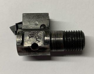

    Pictures
    Here are some pictures of the receiver. It doesn't look as damaged as some in the links folks have provided.
    Here are some pictures of the bolt and bolt head, trying to show the rotation and the channel.
    I will be grateful for any comments or recommendations.

    Check the length of the cut-out and then check the length of the bolt head guide. I had one like your, years ago, and found out too late that some doofus had carefully filed the cut out wider, presumably because the moron thought it would make removing and/or inserting the bolt easier. Visually, I couldn't see the difference because the cut-out wasn't damaged. It was only after I took the calipers and measured it that I found out what had been done. After I took a magnifying glass to cut-out, I could see the file marks. Good luck to you.

    The cut out does appear filed at the rear cut. Unfortunately, someone may have tried to dress it up after it chipped and elongated the slot. Maybe you can peen it a bit to tighten it up. The bolt head overturn is definitely out of spec. The only cure for that is to select fit bolt heads until you find one that indexes with zero overturn.

    Looks like the bolt head guide is 0.539" and the cutout is about 0.547" (hard to measure with my HF calipers). Does anyone know the specification values?
    Also, it looks like I have a Longbranch bolt head. Right?
    Would that cause a problem?
