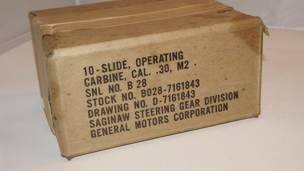

    Same seller with SG M2 Slides. Posted for box markings.
    Link:
    #15 US WW 2 . M 1 Carbine Slide Operating Marked : SG NOS.Unused | eBay
    Charlie-Painter777

    The bands must be later then June 1945 as the M.W.O. ORD B28-W5 dated July 7,1945 directed replacement of front barrel bands B212600 (type 1) and 7160010 (type 2) with new front band 7160963. This was to be completed by January 1, 1946. These bands are numbered D 7161843 so they must have been later and post war.

    Bruce, MWO B28-W5 dtd 7 July 45 was issued after the Ord Department had obtained sufficient quantities of the type 3 bands. Also that is a box of Slides that are numbered D7161843 not barrel bands.

    Wayne your right. I just looked at the numbers and not what was printed on the package. My bad.
