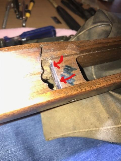

    First priority of what we are looking for...the vertical surface of the recoil lug must bear across the corresponding vertical surface of the stock. The recoil lug should not touch anywhere else. We verify the well was cut deep enough - no contact from the bottom or the sides of the recoil lug. As you can see, these are cut generously. Second, check EVERYWHERE for contact outside of our 2 bearing surfaces, and relieve. Notice the contact on the left side of the receiver.
    Contact from both the flat, and the tang, mean we have something to work with. On the last Minelli stock I did, there was contact all along the sides of the tang, but non underneath nor on the receiver flat, and the wood audibly "creaked" at the tang when tightening. Lots of work on that one. We want level contact on both the flat and tang...the sides and underneath. This stock looks like a really good start, and should not be very involved.
    We use our chisels to LIGHTLY scrape away the black. The material removed will come off like a powder. Don't get aggressive and take off any more, and only remove material that was blackened.
    Attachment 116654Attachment 116655Attachment 116656
    My harbor freight chisels aren't the best. After a once over, I lightly smooth out any tiny gauges with a piece of 150 grit paper wrapped on a 1" chisel. Once its mostly flat, this heavy 1" chisel works well, but not with taking off the initial unevenness.
    The curved surface of the tang can be a challenge. I used curved palm chisels, never taking any chunks, but just lightly scraping off the finish. Tiny sandpaper on a pinky finger will smooth out any scratches you made. The area under the tang barely shows contact. Don't touch it yet. We will want even compression of the wood here in the end. As you work the sides of the tang, the receiver will lower until there is uniform contact underneath.
    Those "edges" in front of the tang are from the milling out of the receiver for the trigger pin area. If you look closely at the metal, you will see it's not flush to the edge, but raised slightly sloping up along where the edge is. This area of the stock must get knocked down so there is even bearing along the tang.
    We keep at it, shave, check, shave, check, shave and check again, until we get even bearing in the 2 contact areas. As the receiver lowers slightly with each shave, check for contact anywhere else and relieve. You can blacken the muzzle area, but don't touch the bedding there yet. As you shave the receiver area, you will noticing the contact at the barrel bed becoming more pronounced, which is a good thing. Next post, I'll post pictures of my progress as I shave/check. This stock gave me a good out-of-the-box start. I estimate it will only take 3 more iterations.

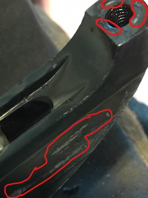

    we are concentrating on the receiver flat, and tang. Working towards uniform contact under the flat, and under the tang and on the sides of the tang. If there are visible scratches from the chisel work, a very light few swipes with 150 grit will smooth them off.
    Fit after 1st iteration (I suppose the last post was iteration 0)
    Attachment 116657Attachment 116658
    It's a bit rough, mostly I think because the first couple passes are smoothing out the imperfections from manufacturing, and the chisel catches on "burrs" in the wood. It may have helped to make a swipe with 150 grit and a finger first.
    We nock down the ridge from the corner by the trigger pin area of the receiver each time.
    After 2nd iteration
    Attachment 116659Attachment 116660
    notice the contact under the tang is getting better. receiver flat getting better too. this is when I notice the underside of the receiver is not perfectly flat in the corner behind the lug.
    Don't forget to keep checking for contact in the undesired areas, and relieving as necessary!

    I fit the stacking swivel band first, then upper band, then lower band. Use a chisel or flat edged file to relieve the front tenon of the handgaurd under the stacking swivel, if needed. I only needed a light pass with a file on this one. make sure there is no barrel contact underneath first...relieve there first if needed.
    Attachment 116759
    Next, fit the front band (with the bayonet lug). keep the stacking swivel on. wipe a light coat of white grease on the inside of the upper band, or on the wood, and push the band on until snug. Don't force it. It should fit tight and snug, but pull of with just a couple light love taps from your chisel handle. This one required no work. it was perfect.
    Attachment 116760
    The screw hole was drilled perfectly too. I have another post somewhere making a repair to a botched hole on a CMPicon stock that was on a Gibbs A4 repro...the holes on the original upper band were off, and so they swirled a drill bit in the wood to make it work, nicking the barrel. No such problems here.
    Next we fit the lower band at the same time we even out the vertical contact between forend and handgaurd.
    keep the upper bands in place... they hold everything steady. Tape them off so they don't get scratched. Start sanding the sides to make flush...some work needed on the right side. left side is pretty close. Stay away from the upper bands and do that area last.

    keep sliding the band down and checking where the contact is. Long smooth strokes to keep the even taper of the forend to the muzzle. I keep going until there is one bands width before the stop. Then, I switch to chisel and file. Notice there is a fat "bump" where the lower band seats. Remove it with file and chisel, little by little, until the band slides on snug.
    At this point, the screw is backed out all the way. Slide the band off or back, and sand the contact areas until it slides on loose, and the forend tapers evenly from the band to the muzzle. Keep checking how far you have to tighten the screw to tighten the band. You want it tight, but so that the swivel still swivels. It is critical that the top of the band sits flush against the wood after tightening. If not, then you don't have the right shape (not narrow enough). keep working it.
