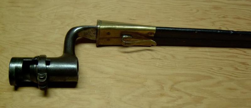

    Bayonet and scabbard.
    The bayonet which is marked” U.S” over “C” over “17” on the blade flat is a U.S.iconBayonet Model 1835……. , it came in a Regulation Pattern of 1839 Scabbard. This scabbard was normally carried in a shoulder belt (baldric) as opposed to being carried on the belt with a frog. This is the correct bayonet for the U.S. Model 1842 Musket, with a correct early scabbard.
