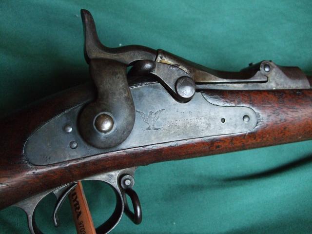

    Been offered a 1888 model rod bayonet, (bits of this missing) apart from that the rifle is in nice condition, apart from a few knocks on the "trap" it looks like hammer marks or similar, this seems to have excess play in the open posisition and some in the closed position, due to age would expect play but how much is too much ?
    I intend to shoot it (if I buy it), the bore is good but has some pitting, thing is I dont want to use Black powder, and have looked on line at various loads etc, the lee loading book has a few using modern powders, just wonder what others use if not using black powder ?

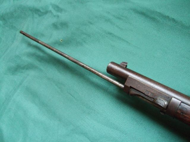

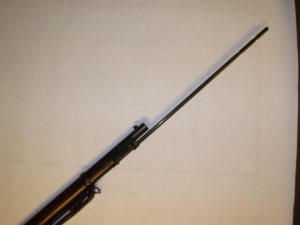

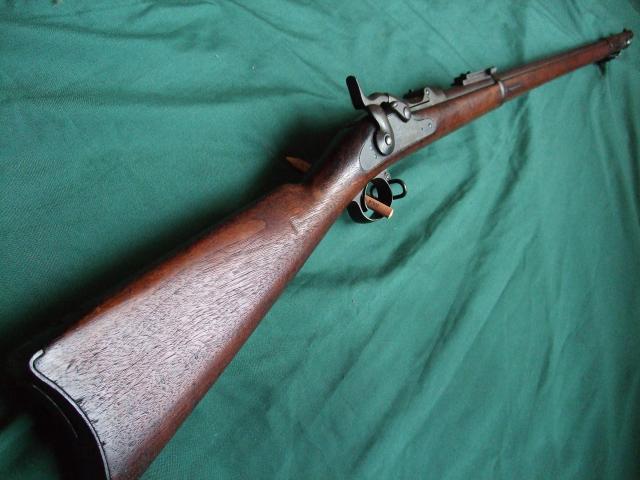

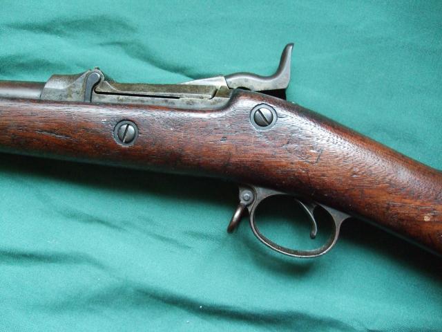

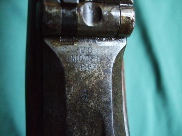

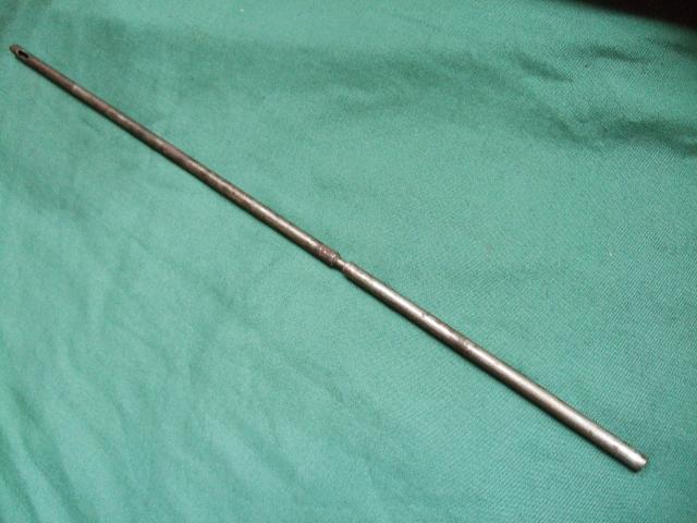

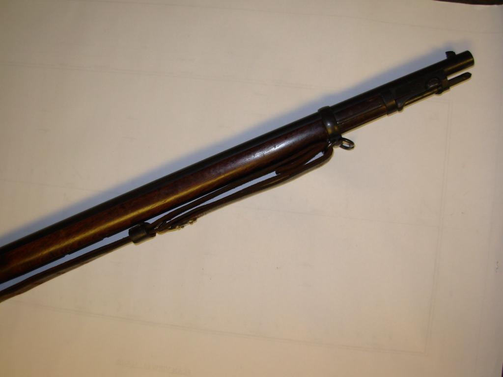

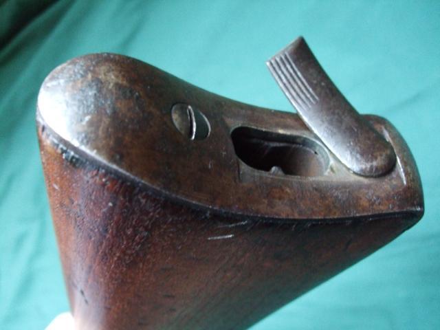

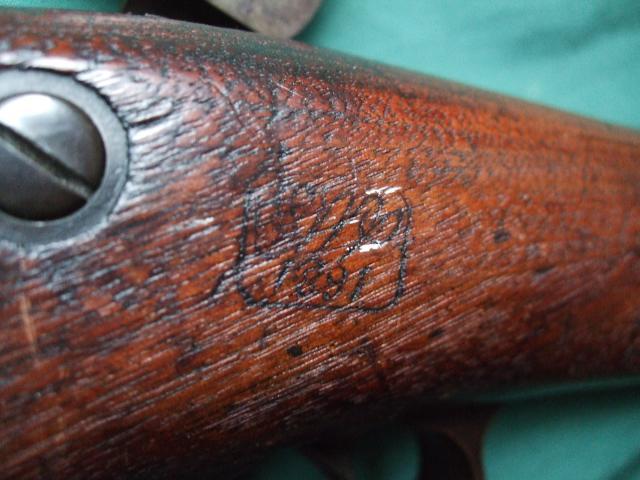

    Managed to get some pics, also had a kind offer from A square 10, so have some dies now.
    one question is the Rod bayonet, I know it was a cleaning rod also but I assume it was fixed like one of the last pics, but has anyone got a complete rod to compare it to ?

    dont know how much help these photos will be but here is my photos of my 1888 rod bayonet trapdoor .....ignore the sling - it came that way & yes i know its on wrong
    we may need to seek out a replacement bayo for you - i cannot tell for sure by the photos but it looks a little off , should be three shoulder cuts
