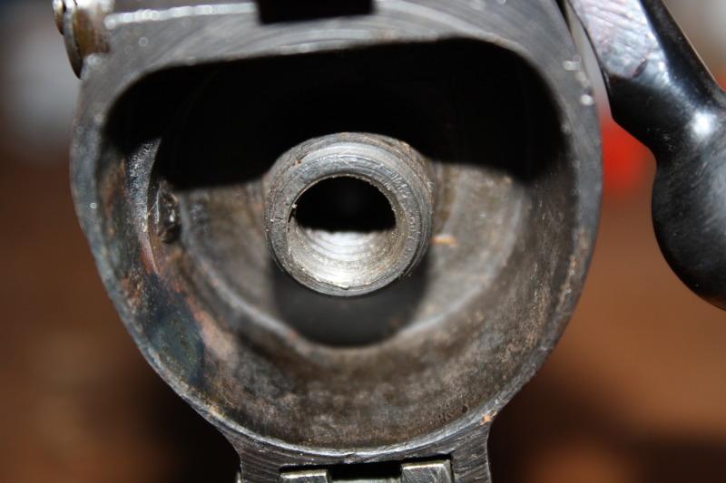

    Picked this up a few days ago. A Longbranch Trade Pattern sniper with a Lyman Alaskan scope.
    It was advertised as a reproduction, and I knew it was. Nonetheless, it is a beautiful rifle and I am happy that I purchased it. Questions is, would this type of serial# alteration ever be performed at manufacture or at depot level service? I only question the forgery issue due to the care and, dare I say, skill it took to perform this type of work. If so, I wondered if it paid off? BTW if anyone owns a LB with this serial # PLEASE give me a shout

    Looks like the original serial number was welded over and a new one stamped. Very good job as the font and size looks correct. How is the scope marked? Ron

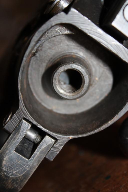

    rgg 7 has it. The pics of the inside show the raw weld bead. it was definitely re-numbered at some point and this took drilling out and putting a spot of weld material in the void and then re-stamping. The font is a bit different on the "7" "4" and "L". I will post full size pics in a few days, but just wanted to focus on the serial number change for now.

    Anytime one sees file or sanding marks in the area of the serial number on a LB receiver, one must suspect that the serial is non-original.
    To my knowledge, that type of renumbering was not done in the Cdn ordnance branch. By the book, if a rifle was to be renumbered or a receiver salvaged and recycled, the serial number would be barred out (not obliterated) and the new serial number placed nearby. By the book, if the serial number on a weapon showed signs of tampering, the weapon would be back loaded to third line for investigation.
    I have seen examples of various rifles and smgC1s with the proper barring out of the numbers as I have described above. One exception to this would be the thousand or so Cno7 receivers that had the serials scrubbed and placed in stock after being salvaged from Cno7 rifles.
    Almost surprising that someone would go to all the trouble of trying to fake up a TP rifle, and not take the time to take a rotary file to the blob of weld on the inside of the wrist.

    Quote Originally Posted by stencollector View Post
    Guess it was easier to notch the buttstock after all that fine work and not count on anyone going inside for a look....like me.

    Gauging from the size of the weld, it looks like the 74L was drilled out and refilled with weld the restamped. ANY place takes a dim view of monkeying with serial numbers: US, or anywhere.....
