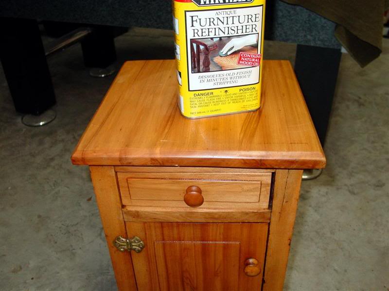

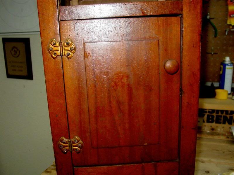

    Below is an extreme example of an old smoking stand I used it on.
    The second photo is what it looked like after just cleaning the buildup off with 000 steel wood and Minwax (and lots of rags). It doesn't strip and dry the wood out requiring sanding, new stain, etc.

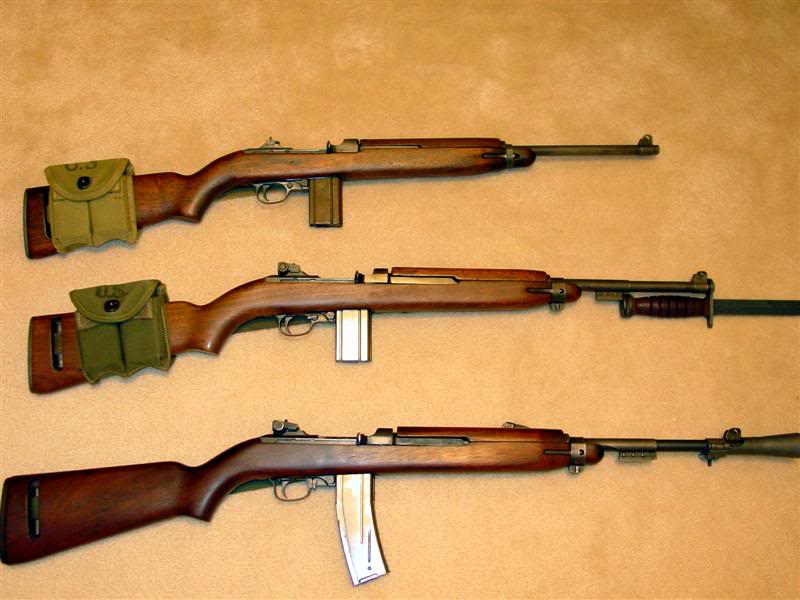

    These carbine stocks below were almost black with old crud and they came out well.
