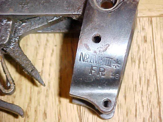

    What markings are on the butt socket ?
    They would normaly be on the right hand side (beneath the bolt 'knob'), however if it has been FR'd at ishapore they will have scrbbed all the original markings and re-marked it on the left hand side of the butt-socket.
    If it has been Ishapore'd then it may look like this :
