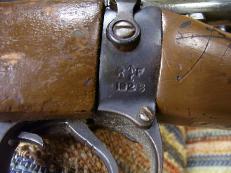

    GUNZABLAZIN's Avatar
    01-19-2024 @ 10:36 AM
    Ft.Wayne,Indiana
    8
    04-29-2025
    05:28 AM
    Here is a picture of my 1918 Ishapore No. 1 MkIII with the * lined out.
    RIF in 1928
    Magazine cutoff reinstalled, no Ishy screw, no import marks
