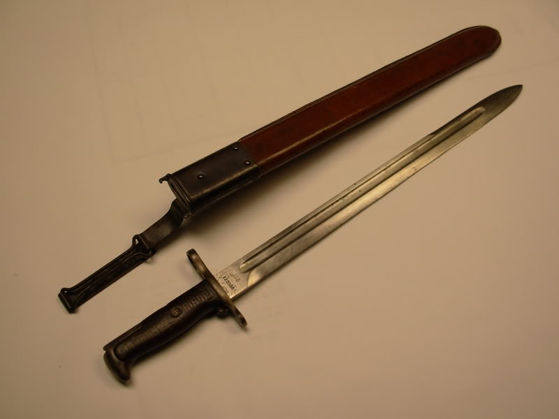

    rongee has the info i would have added , i do have an early RIA M1905 tho so ill post it , the blueing doesnt go much beyond the cross guard on mine eather , it is in original bright finnish -

    Thanks. A picture is worth a thousand words. Love those pictures.
    That's a pretty nice rig. I have an SA with a 1905 scabbard that I ma prety proud of too.
    This thread is about the RIA's though. I swear that there is no blue beyond the guard on my 1909 RIA and never was. It just doesn't look like there ever was anything there. The guard is in real nice shape and the blade from the guard forward is bright and looks like it always was bright.

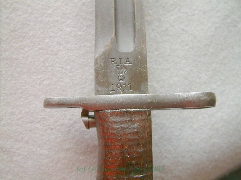

    The "Line of Blue" on most RIA production is very narrow, unlike that of Springfield which is much wider. In most of them, it is less than 1/32 wide and in some probably not more than 1/64. I agree that on most of them, there is only a hint of a line. Apparently Rock Island did their final polish almost up to the guard. I should have made this distinction more clear in my book. Hopefully one of these days I will get my Bayonet Points article on the Model 1905 bayonet finished and will try to be more specific .
    The one in the photo is about as wide as I have ever seen on a Rock Island.
