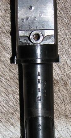

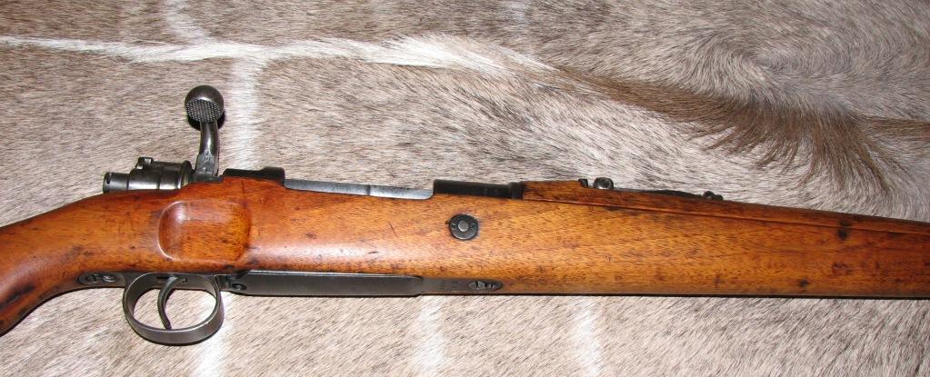

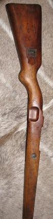

    1910 Erfurt K98

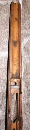

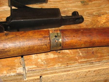

    I recently picked up a 1910 Erfurt K98icon. I must apologise that I did not take enough pre photos (sorry Patrick, Badger et al). I washed the stock and removed a lot of black crud from the stock. The barrel was very rough and dark looking with a 5mm hole. At first glance the bore looked beyond redemption, after a good deal of cleaning it looks reasonable, and 8mm.

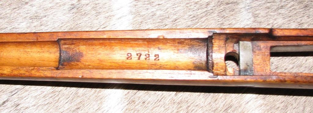

    The stock had been repaired with a brass sheet where it was broken completely through. I re-enforced this with metal rods and acrabond, as well as the previously used brass. There was very little rust, all parts seem to have matching serial numbers.
    I am now oiling and "boning" the stock. I did not have BLOicon but I did have a good amount of tung oil which has done very good services on sporting rifles for me.
    I will post photos when the rifle is complete. If any of you well informed folks notice anything unique in the markings I would love to hear your comments.
    I assume from the vintage that this rifle has the .323 bore. I will check dimensions before firing. I will welcome comments on this as well.
    Not a major restore like the Argentineicon rolling block (a truly epic post thanks guys) just a bit of elbow grease and some love. More photos to follow when complete. hope y'all enjoy. GRF

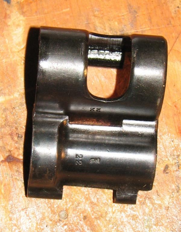

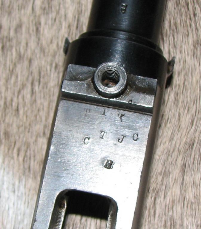

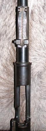

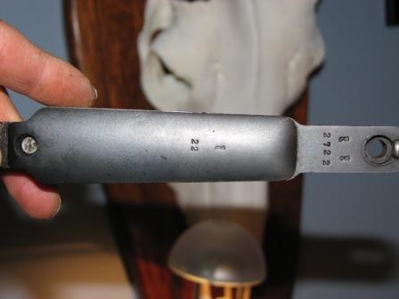

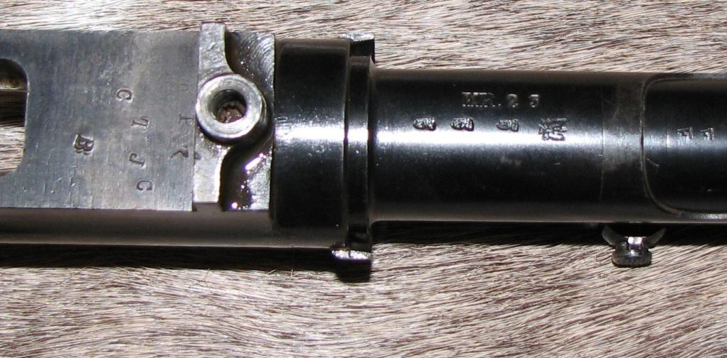

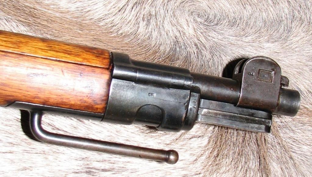

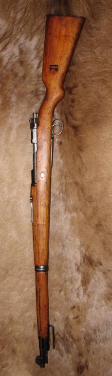

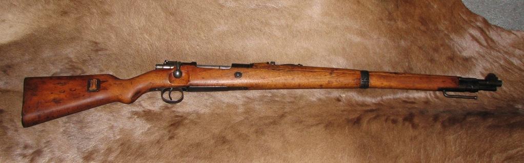

    Everything is cleaned, oiled and back together. The wood was quite dry and absorbed a good amount of the tung oil. If I was clever I would have weighed the rifle before and after.

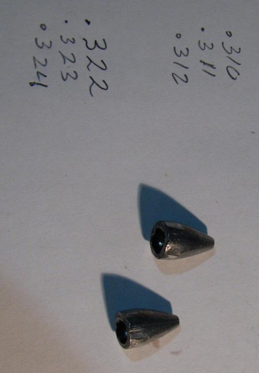

    I slugged the bore with lead "worm weights" and as expected it was .323. The lead weights worked very well especially with the pointed front the worm weights have. The action closes with slight pressure on a fully resized 8X57 case, therefore I assume we do not have excessive head space. Do the cognosente here think I need to have this checked by a gun smith before firing? I am inclined to think she is in fine form and range ready; however I would appreciate comments. I am planning on using reloads which replicate WW2 velocities and pressures. again comments on this are welcomed.

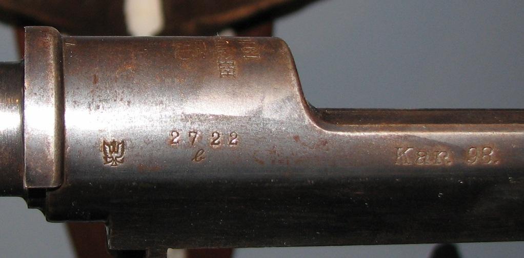

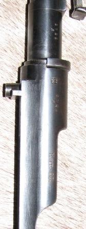

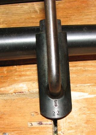

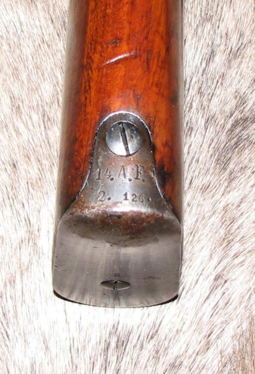

    I would also like to know the meaning of the wee eagles (I assume) found on the rifle in a few places, so again please comments are appreciated.
    I have repeated some pictures which were shown earlier as I was able to get a better photo. Hope y'all enjoy. GRF

    Kar. 98. markings
    A very nice example of a type of rifle of which most examples were bashed about in WWI. Matching numbers, clear markings - and an obviously shootable bore - you are lucky!
    The eagles are proof marks.
    14.A.F.2.125.
    = Badisches Fussartillerie (State of Baden, Foot artillery (i.e. not mounted)), 2nd Batallion, Rifle No. 125

    [/FONT][/SIZE]14.A.F.2.125.
    Patrick a good post with good information but I must say that the "2" in the translation of the regimental stands for "Company", not "Bataillon". so "14.A.F.2.125." would read 14 Regiment, 2nd Company, weapon #125. Of course, as you say, the 14th Fußartillerie-Regiment of was indeed from Baden as you say and it was part of the XIV Armee Korps at the beginning of the Great War.
