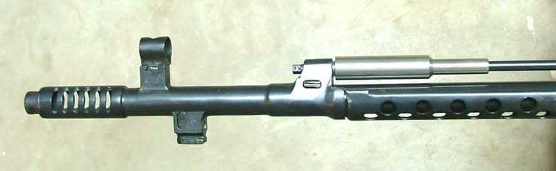

    I got my first SVT-40 back in 1966. The rifle is interesting to shoot and keep shooting.

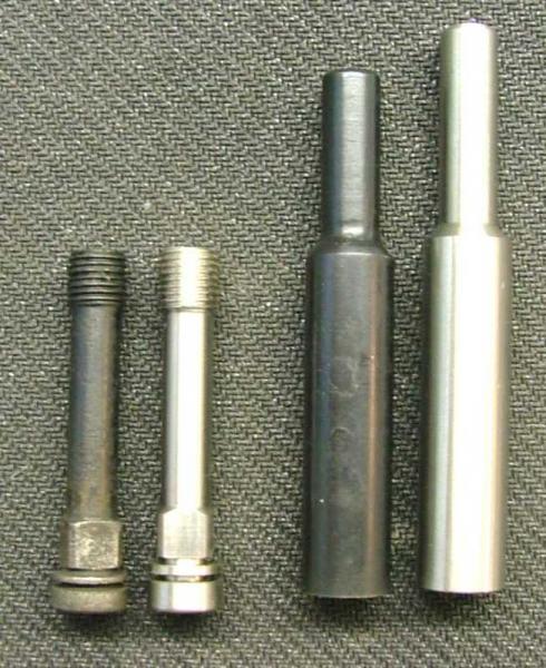

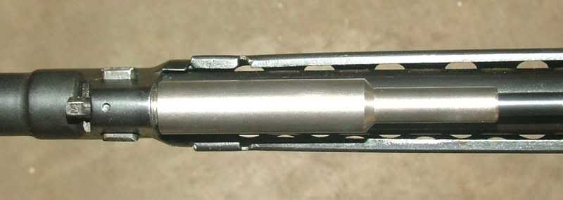

    What you may want to look for is the fit of the piston to the gas cup. These two parts will cause about 99% of all the problems you will have.
    When the two parts are in good condition,or new replacements ( one of our members makes new stainless steel cup/piston) the gas system can be tuned to operate with little or no damage to the fired brass. The flutes on the neck and shoulder are very shallow and the brass can be reloaded.
    Any time the brass is torn in half,or badly dented it is because of a worn cup/piston causing the user to set the gas plug to a setting greater than 1.2 or 1.3.
    The rifle is accurate for what it is. Recoil is very light due to the very efficient muzzle brake.
    The stock is not the strongest design out there. Keep the action/stock screws tight to help prevent a crack at the front of the wrist or recoil lug.
    Ask if you can check the rifle out before you buy it. Pull the operating spring and hand cycle the cup on the piston. It should have a slight drag to it. Like a piston in a cylinder! there should be no "felt" play between the two. The fixed piston should be tight in the gas block. The piston head should NOT be all eaten-up by the corrosive primers/gas pressures.
    If you find these conditions on the piston/cup,you will have problems with the force needed to cycle your rifle.
    Over the years since I bought my rifle I have fixed about 50 rifles. As I stated above, the gas piston and cup are the primary cause of cycling/ejecting/feeding/damaged brass problems.
    If your lucky enough to have a rifle with a good gas system the rifles is just plain fun to shoot. It has a muzzle blast like a 105 howitzer, and can be shot all day with out destroying your shoulder.
