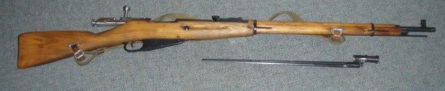

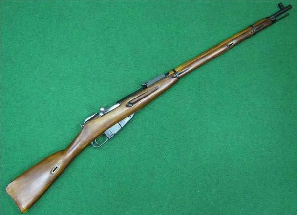

    Just for reference since the original poster asked for photos, here is my m91/30 that had the shellac removed with methylated spirits, then refinished with raw linseed oilicon, since it was what I had on hand.
    I know, I know, its not really original, but I bought this rifle is for shooting, and I find that my hands slip all over the place on shellac, especially in summer. Theres no point in me owning the rifle at all if I don't enjoy having and using it, and the shellac was getting in the way of that.
    Before:
    After:
