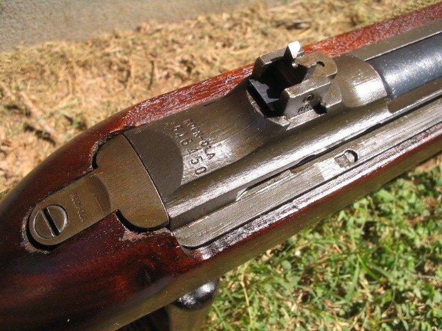

    If at all possible, one of the best things to do would be to look at known originals close to your serial number range. Here's two that were made just prior to yours. Both have type IV housings. The first just recently sold on GB, 4547xxx. Please see attached link.
    Rockola M1icon Carbine Type I All Original .30 Cal : Curios and Relics at GunBroker.com
    The second, 4546xxx is pictured below. hth.

    David,
    Is that the RO with the sight like my Inland?
    It sure would look good Next to mine!!!
    Dave
    dbarn's Avatar
    04-05-2017 @ 10:46 PM
    412
    04-29-2025
    10:27 AM
    Yes, that's the one! Very nice Inland...........
