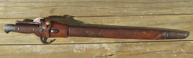

    Well here's something that came with a story.
    Supposedly this was bought back by a Kiwi soldier from Gallipoli.
    Now I always buy the object not the story,and that's exactly what I have done in this case.
    However having researched the said chap there was indeed a Kiwi gentleman of that name who served at Gallipoli.
    I think its indeed probable this bayo did belong to him,but perhaps more likely bought by him privately sometime after the war rather than bought back.
    Which brings up the question,could returning Kiwi soldiers (both Wars) in fact keep/purchase their weapons if they wished?
    If they could would they have sold out of service marks applied,as this bayo has?
    What was the procedure for returning soldiers,did they still carry their arms off the boats to be collected later or were they collected on the boat before disembarking?
    Its not the first time I have come across rifles etc that were supposedly carried by some chaps grandfather or other,but unfortunately without provenance its just a nice story.
    Sometimes however there are ways of disproving these one way or another with a little detective work.
    Oh,one more thing,the frog (which did not come with it) I am told is a specific NZicon pattern,can someone confirm this?
    Cheers,
    GDU

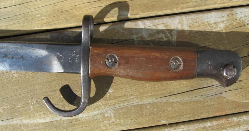

    I think the 'X' marking is a bend test proof, not a sold out of service mark:

    Nice bayonet, The mark on the pommel is the sold out of service, the X on the blade (Ricasso) is the bend mark.
    Must get that eye test booked...

    THe sold from service mark on a quillioned blade is always intersting as all quillions were removed in 1916 - or were supposed to be - and it woudl seem very strange for someone to sell blades from service during the war, or so soon after it was introduced to service. One can always assume that this markign is actually post WWII and came from a rear echelon unit that didnt remove the quillion, or stock sitting in stores that never got issued. Don't suppose the story will every be learnt
    As for the frog yes it is New Zealandicon bookmark

    It used to be an absolute offence to possess government stores, indicated by the big WD arrow. So poeople that had previously 'liberated' or 'diverted' or just plain stolen some of this kit took it upon themselves to mark it with an extra arrow to make the 'sale-mark' of two face-to-face arrows look genuine.
    The old Army equipment regulations contained a whole chapter explaining how to tell the real thing but it was of little use because mere possession ceased to be an offence. So anyone with such a marked bit of kit soon learned that the best thing was to say to anyone silly enough to investigate too deeply was simply say words to the effect that '........ if you think that it's stolen, then you prove I stole it. Possession isn't an offence so I don't have to prove anything'
    Just a thought................ but I think that bayonet slipped out of the gate

    The 'sold out of service' mark in this case does not mean it was marked when leaving service. I believe this mark indicates it has been sold out of Britishicon service and into colonial (or NZ.?) service.
    I have a number of British made quillon bayonets of that era that have this mark, and most have WW1 Australianicon marks present as well. I have also seen pre-war scabbards with WW1 Lithgow repairs done.
    Equipment was being sent to the 'colonies' during that 1910 period and it was being marked with the SOS arrows. Much of this equipment ended up going back to Europe again with the troops to serve in the war.
    The Sanderson example pictured below is interesting as it has been 'sold out of service', marked with Aussie MD ownership marks, had its hook removed during the war, but has never had the clearance hole drilled.
