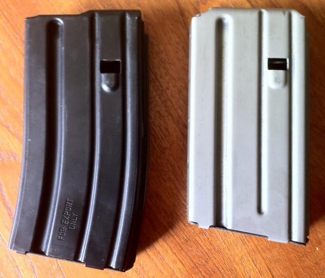

    The one proviso there is that if they are the newer style 20 round magazines with a slight curve, then the followers will fit them.

    DPMS 20 Round on left, standard USGI 20 on right:
    (Although this particular magazine is DPMS, others do make the same type.)

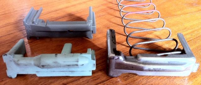

    All my standard Colt 20 round magazines have alloy followers, but if your original green followers are like these, then the Magpul will fit:
    Bottom left is standard green follower, above it is Magpul Enhanced Follower. Follower on the right is the H&K SA80 A2 magazine follower - that I guess Magpul used as a pattern!

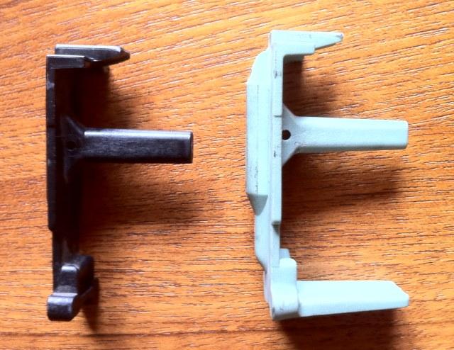

    FWIW, the green follower is already an 'anti-tilt' upgrade to the original black followers:
