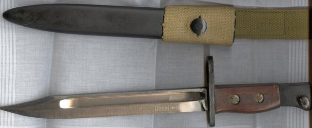

    Does anyone know what type of bayonet would fit a Sterling Mk 4? I assumed an L1A1 bayonet would fit, but they don't because of the smaller size of the barrel ring at the hilt. It would appear the Sterling mounting ring is much larger. Can anyone advise?

    The commonly refered to #5 Jungle carbine bayonet is the one you seek. The UKicon called them the sub-machine gun bayonet. It has a sustantially larger ring.

    We didn't change the nomenclature BAR. Throughout it's life in UKicon service it remained the 'BAYONET, No5 Mk1' together with its old No5 rifle part number, as did the scabbard, right up until the end of its life as the L1A1 rifle scabbard. So if you're offered a No5 bayonet as BAR says Grant, take it. But be advised that if the ring is tight (if you'll excuse the phrase.........) on the muzzle of the SMG. That's because some rings were slightly undersize and just need clearing out with a few strokes of a file.

    OK Gentlemen, guess I will have to start to hunt down a no 5 jungle carbine bayonet. Thanks for the advice it is much appreciated. When I find one I will submit some pictures of my "Rolls Royce" of machine guns (As Peter calls them!) complete with bayonet.
