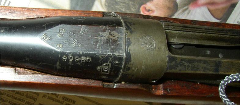

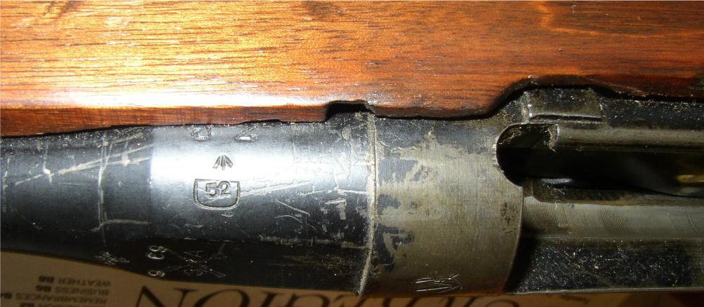

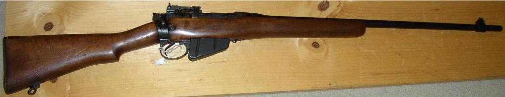

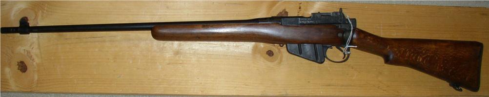

    I picked up several rifles today from my FFL (the 10 day "cooling off" period had run its course). One was this sported No4 MKI. I think it can be re-milled without too much trouble.
    I thought all the "PF" guns were MKII's.
    All the numbers match...shame someone cut it up.
    Notice there is some kind of shim in the barrel channel near the end.

    Sout African property marks.

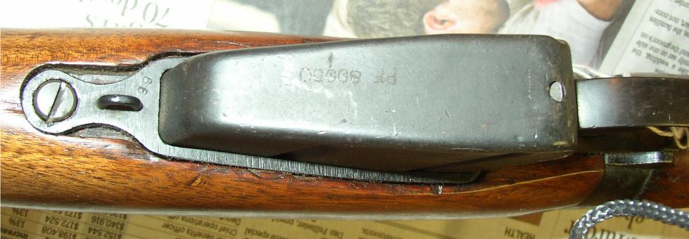

    What is that great chunk missing from under the knox form (5th picture) all about?

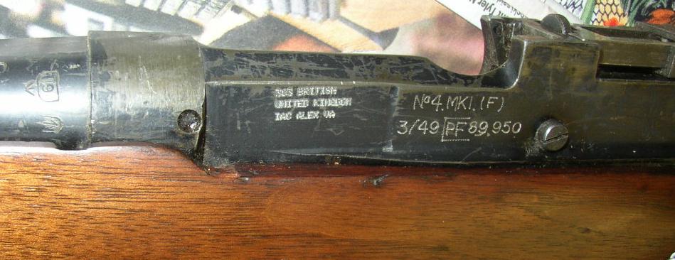

    Why does the cutout in the forearm not match the trigger guard (picture 6)? I've got other No.4's and the trigger guard profile is different on this one.

    There is a crossed rifle and arrow stamp with the numbers "9" and "69" and letters "S" and "A" on top of the barrel, near the receiver. I assume the SA refers to South Africa. Do the numbers 9 69 refer to the date?

    Re the cutout on the fore-end. Your trigger guard is the lightened No5 trigger guard that was made for the No5 rifle but because it fitted a No4 and was identical in every other way, it was standardised as the norm for the Mk1 rifle. I think that the part numbers were eventually amalgamated during the L42/No8 era so it was pot luck whether you got a No4 or 5 trigger guard through the Ordnance system.
