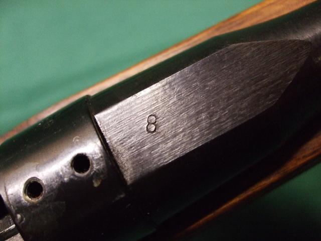

    Bought a sporterized No4 Mk2, not so long back for a parts rifle, the bore was rusted through but it had a decent body and an original 7.62mm magazine, the barrel which had not been cut down still had its bayonet lugs etc which I would of relined to .22
    Further inspection when I picked it up and after a good clean of the bore it came up well, no marks on the barrel except an 8 on the knox form, also no spacer fitted so would say its not a sterling barrel, anyone any idea,s of make etc ?

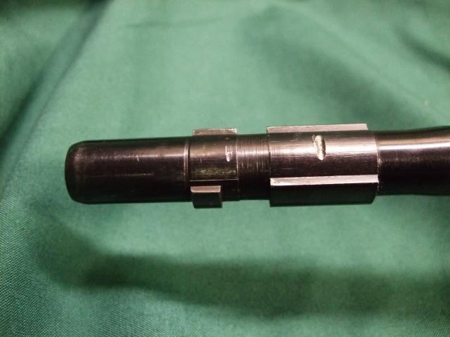

    Original Enfield L8 barrels have flats on either side of the barrel by the Knox form, this was for the new breeching tools Enfield were going to use! There were other makers of 7.62mm barrels, A.J.Parker, Sterling, Delacour(Belgiumicon) and possibly Parker Hale! All with bayonet lugs unlike the Canadianicon barrels without lugs

    We could discuss this further but the 1965 series production L8's proposed to 'fill-the-gap' were going to use Belgian 'Cannons' barrels who couldn't supply the quantity or the quality. Canadaicon could - and did but by then, India had told the UKicon Government, in as many words '....... No Sterlings, No 7.62mm No4's either........'
    The what were called 'spanner' barrels (with two flats) were a simplified barrel that could be fitted without the need for the more complicated part of the breeching up set. The drawings exist for .303" 'spanner' barrels with breeching up washers too............

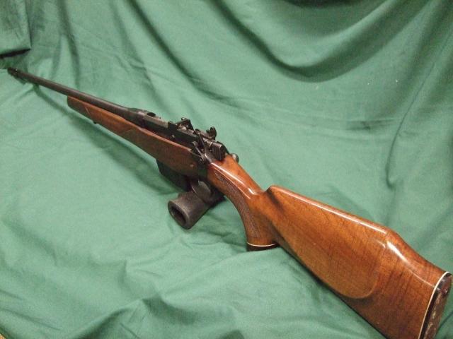

    Some pics of the barrel, and how it looked.

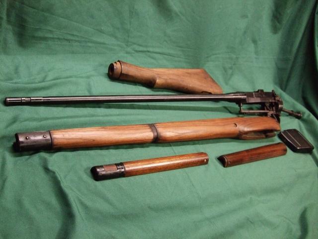

    Last pic shows the bits ready to fit (the butt and fore-end are NOS, so will have dig out Peters instructions on fitting them).

    I've got a similar barrel, unmarked except for a ".308" stamped on the flat where yours has an "8".
    I assume its a civilian trade barrel, possibly Belgian.
