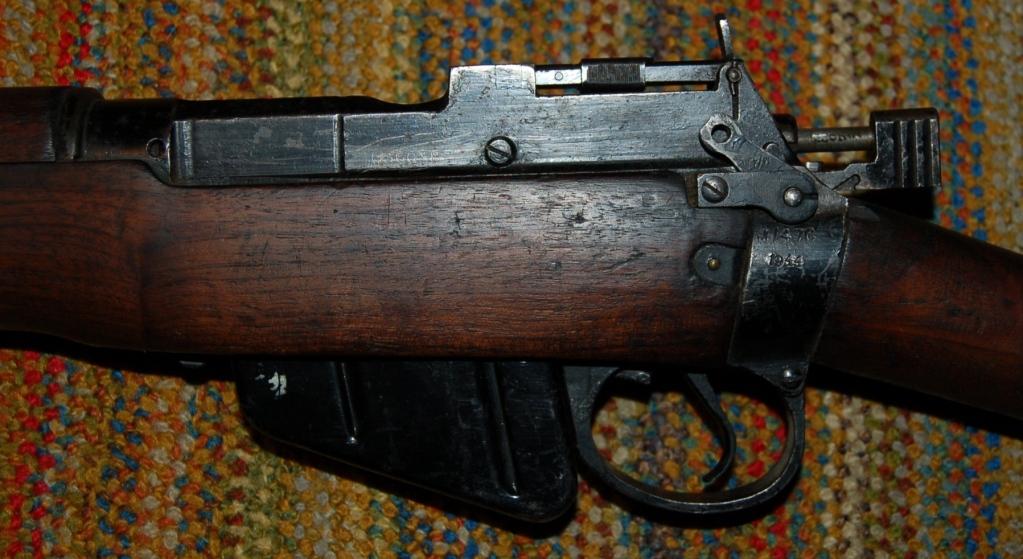

    I'm a little familiar with the Suncorite finish and this paint just doesn't quite seem right. It' very brittle and comes off with your fingernail. It's also fairly high gloss. The magazine serial number matches the rifle so it's original to it, the paint on it's bottom half appears to be the same as that on the receiver so they were probably applied at the same time.
    I have not taken the wood off of it yet, will do that later today, but I have found no rebuild marks on the exterior. Only added marks I can find are the Britishicon Nitro Proof marks, a small one on the receiver and a longer one on the end of the barrel. This paint is so thick in places that it could be hidden under there. Prior owners scraped it off the side of the receiver to see the serial number. There is no paint on the portion of the barrel sticking out of the stock.
    The upper half of the magazine looks to be the same finish most British magazines have, a dull grey/black color similar to bluing but not as shiny.
    It does appear to be a repaint job to me but I haven't handled enough of these to know the difference. The finish on my Jungle Carbine is an even thin coating, this is pretty thick.

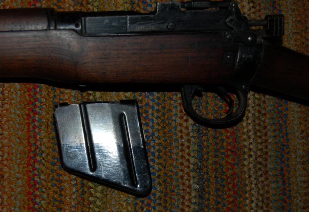

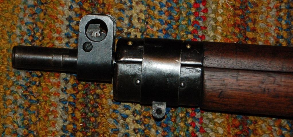

    Photos will probably make this a whole lot easier. There is a big glob of paint on the barrel end I hadn't noticed yesterday. With the magazine out, you can easily see the difference between the paint and the original metal.
    So my questions are, should I remove the paint from all surfaces or just the magazine. Should I then repaint it or leave it alone. I've looked at photos on the web and see all sorts of levels of paint/non-paint.

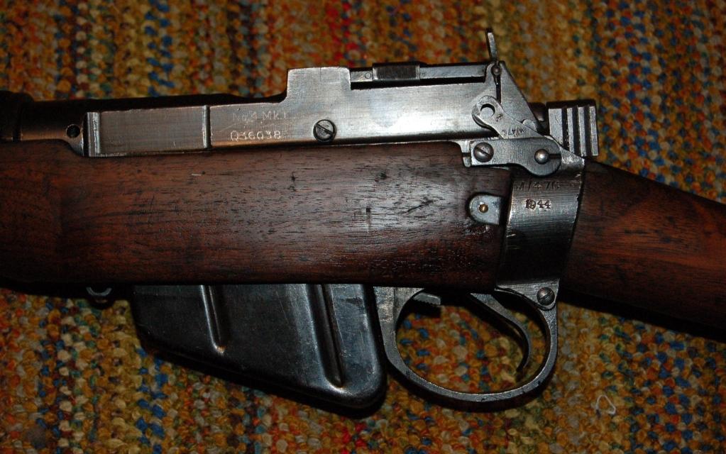

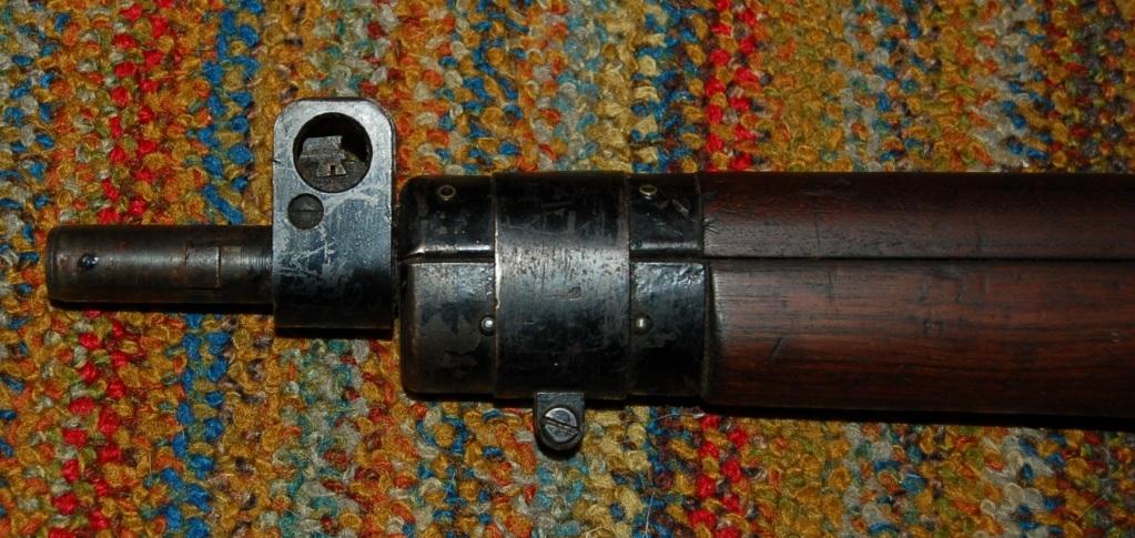

    Here's what it looks like with the paint removed:

    I think for now I'm going to leave it alone. I'm not trying to make it look new and the surviving park finish isn't all that bad. The flash on the receiver wall makes it look like there's none there but it's pretty consistent with the safety leaver. The only part that is almost in the white is the bolt. That I may do something with but I'm just going to wait a bit.
