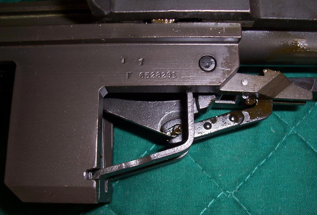

    Hey Guys!
    I just got a really nice Late Springfield Garandicon #5851XXX and was wondering about the markings on the trigger group parts. I haven't even inspected it closely yet because I'm at work and picked her up at Lunchtime and brought her home. I do know the number on the side of the housing is correct, and the number on the hammer has an "SA" in it. What, if any, numbers would be on the rest of the parts in the trigger group to be SA? Thanks in advance!

    Why don't you take some pics and show us what you actually have. Or at least write down the numbers you actually have so we can help. You need to get Scott Duff's books on the M1icon to help you in your identification from this point on. This will likely only be the beginning of having M1s.

    Well, I got the pictures taken this morning but I didn't have the time to get them posted before work. Hopefully tonight.

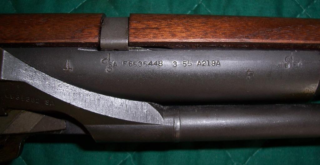

    Pics...
    Pics...

    Well, it looks like all later parts and a definite clean shooter. Nothing special just good and clean. I take it all the wood's in as good shape as the top piece we see?

    06-13-2025
    12:06 PM
    Everything that's pictured is correct with the serial number and date. The drawing # on the bolt should be 6528287-SA, and the heat lot # can be a few different one's, not sure which one's actually, but A14 and A15 are probably two of them that are correct.
    Well, thanks... (I think). I like the "nothing special" comment. No offense but I'm well aware of how rare it is to find such a clean example of a Springfield Garandicon that's this "correct". Granted, I know it could have been recently assembled from correct parts, but having the receiver and barrel match and be so new looking is half of the battle in my humble opinion. For the record...To my knowledge, this rifle was NOT recently assembled from parts. All of the metal parts appear to be the way it left Springfield Armory in 1955. The TE is around 1.5 and MW is less than 1. Yes, the wood is nearly perfect but I'm sure it's a replacement stock as there are no cartouches or a circled "P" on the wrist. Thanks for looking... And the comments. I really do appreciate it!

    Quote Originally Posted by SlayerNut View Post
    Yes, the drawing number on the bolt is 6528287-SA and the heat lot is J-1-A. Thanks again!
