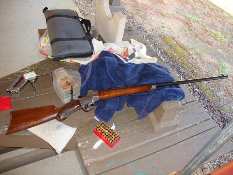

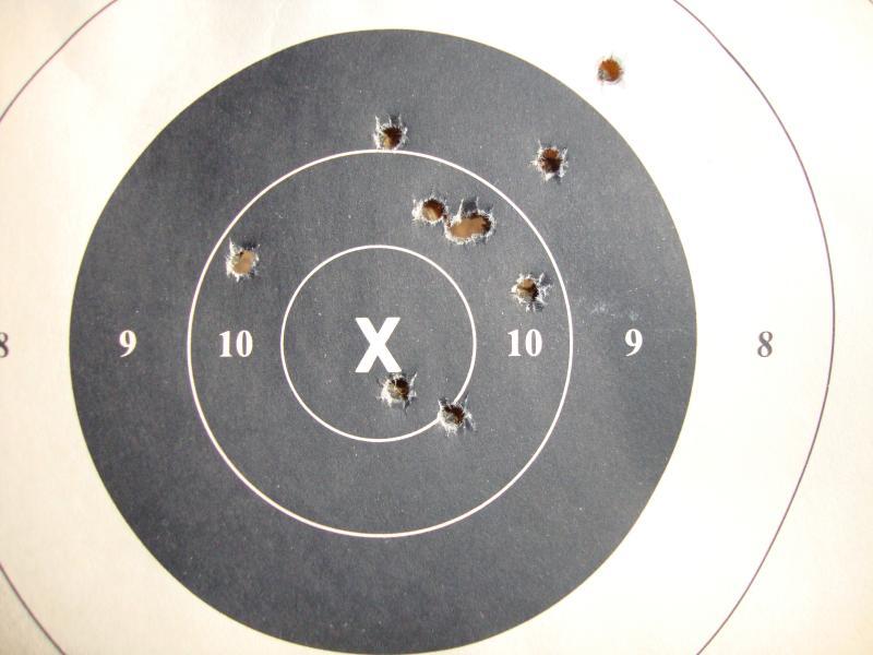

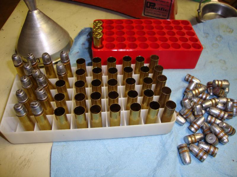

    If it was mine, I'd be working up some BP loads, but a friend let me borrow this fine piece to test the scissors mould Ideal 115 bullets cast this seek. Using only the proper weight bullets with visual defects for an initial trial, the results were encouraging. Not the 1 1/2" five shot 100yd group done with old factory Winchester ammo the other week, but not horrible. Certainly better than the factory Remington lead bullet loads which would barely stay on paper at 100...
    10 shots in 3 1/2". 8 in 2 1/2". First shot out of a freshly cleaned barrel was the left-most. Not disappointed! These bullets all had visual defects, but were within -1/2 grain of 115 gr nominal weight (Pre-lube).

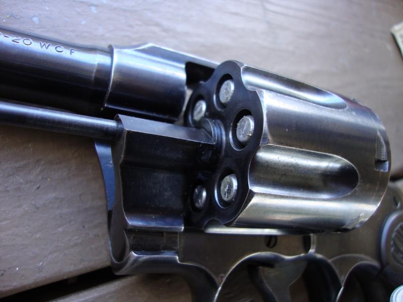

    Also tested the load in some revolvers with good results. [The Army Special outshot the Python (using .38 wadcutters) at 50yds.]

    BTW, the chambers on two of the revolvers are tighter than the rifle, and the OAL was set by the Colt Army Special:
    So there's plenty of room for fine tuning the rifle from this point. Maybe we'll see more of it...

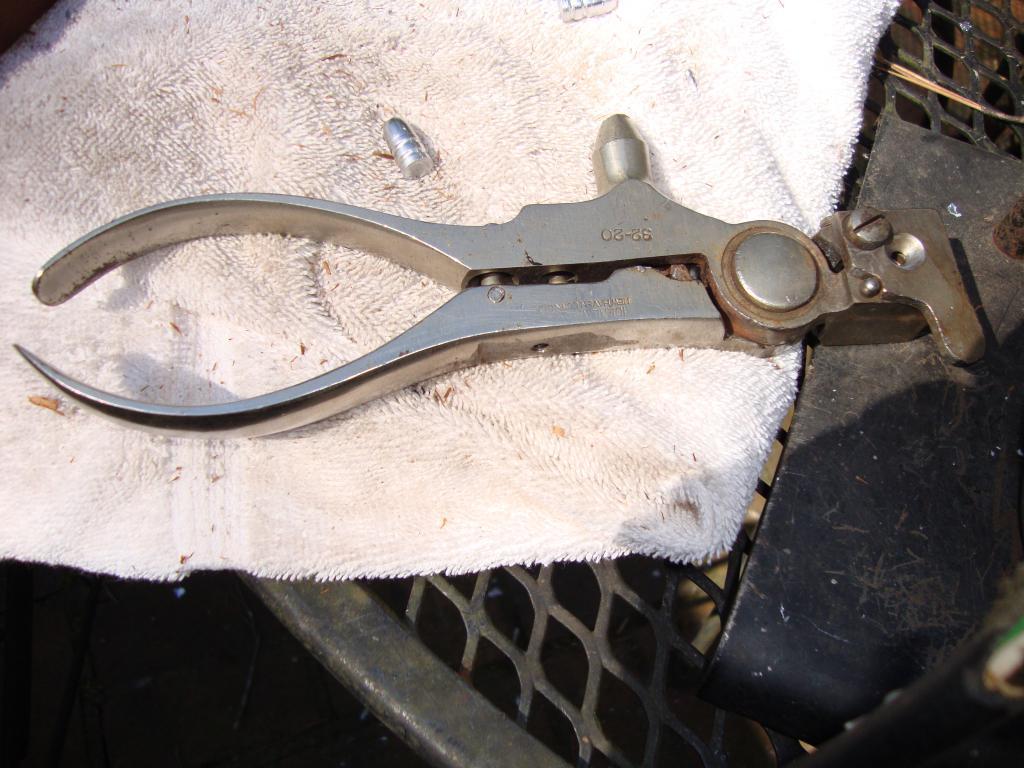

    Already have a fine mould and reloading tool for the caliber!:
