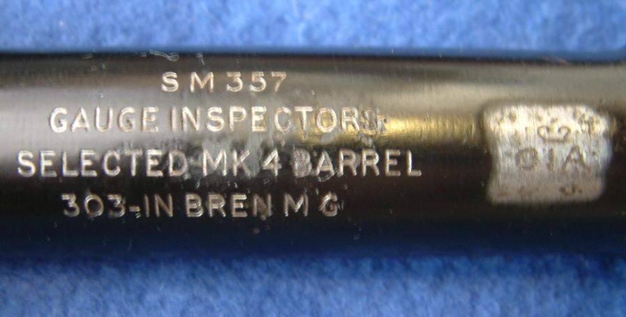

    What is special about this "Gauged" Mk4 barrel???
    Bren MK4 Lightened Barrel, Selected as Gauge W/No : Rifle Barrels at GunBroker.com
    Why is this barrel marked as a "Gauge"??? Were they ever mean to be assembled and fired? CAN they be fired??
    What areas on the barrel (tube) were meant to used to measure/act as a "Gauge"??
    -TomH
    Yesterday @ 09:42 AM
    16,684
    06-30-2025
    09:27 AM
    They were definately NOT to be fired!!!!! The Gauge barrel was really a specially selected barrel. made to the exact outside tolerance or if you were an engine buolder 'blueprinted' It served the same purpose as the bolt gauge on the rifle. In short, the gauge barrel was used to ascertain whether it was a barrel that was faulty or the gun body. Usually it was used to test for wear on the barrel seating, just to the rear of the barrel locking nut. It was also used to test whether the breech block stops were worn too.
    THey didn't have a flash eliminator nor a gas hole in the gas block.
    Ours were left in bright metal as I recall and the muzzle end was painted yellow just so it was easily identified. Guns with a worn barrel seating wouldn't allow the/any barrel to tighten up, even on the largest size barrel nut. At Base workshop the barrel seating could be bored out and a new sleeve pressed into place and machined to suit. You can often see the new sleeve insert on L4A3 and 5 - ex Mk2 bodies

    I'd point out that per my original post on this, these particular "Mk IV" barrels are indeed cut of the FH. See the picture.....
    Attachment 56463
    And, Peter, reason for interest is that there are, essentially. no other Mk IV barrels available here. While your idea of simply profiling an existing Mk II barrel is of course correct, not everyone here has access to a good lathe for one, and for two.........would you kindly have access to the actual dimensioned original drawings for said MK IV barrel....for those of us that DO have the machining capability?? ;-) ;-)
