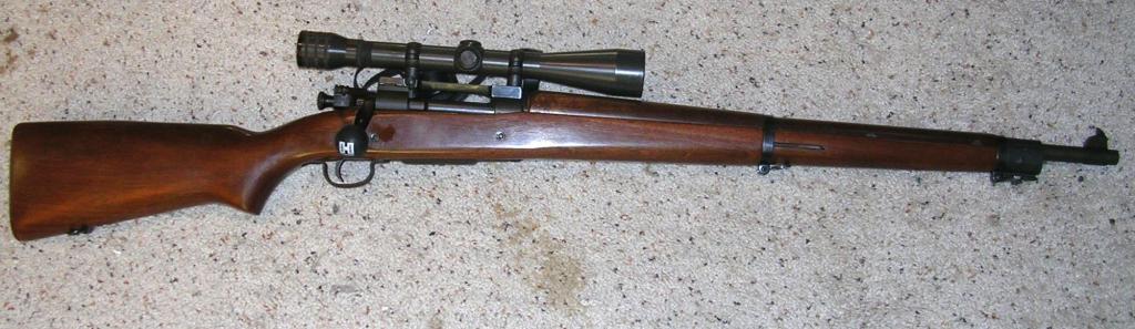

    Bought a totally unmessed with SC 03A3 that had been put in a sporter stock
    Found the wood, bands,buttplate, etc at Numrich.
    Found a bent bolt on Ebay (better headspace than the original)
    Redfield still makes the base. Found a guy who can D&T the rock hard all the way thru SC receiver.
    Had a mint Kollmorgen 6X PCH and 26mm rings.
    Stoned the trigger down to 4lbs (from 12 !)
    First trip to the range (no tuning at all) dropped 5 1965 GI loads in 1.5".
    Total invested <$1000.

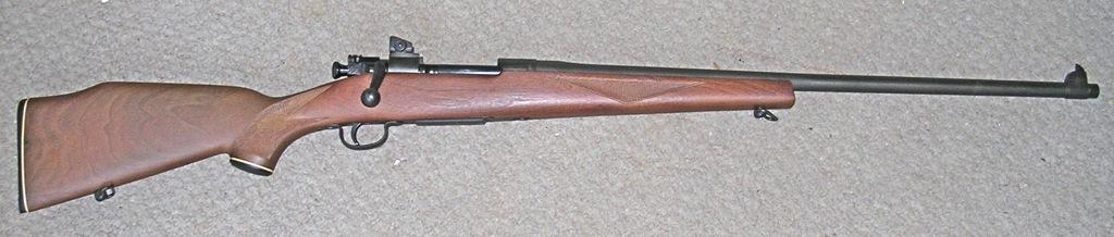

    Nice just got mine today.
