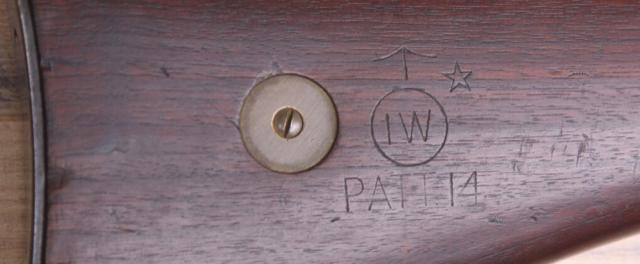

    Pictures of your rifle would be highly appreciated. Is the stock still marked IW in a circle?
    The thing that sounds strange to me is that a WINCHESTER made rifle would be in the REMINGTON collection. Since they produced these rifles themselves, wouldn't they rather keep their own rifle than to keep one from a competitor?

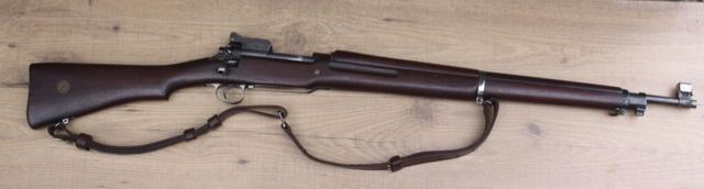

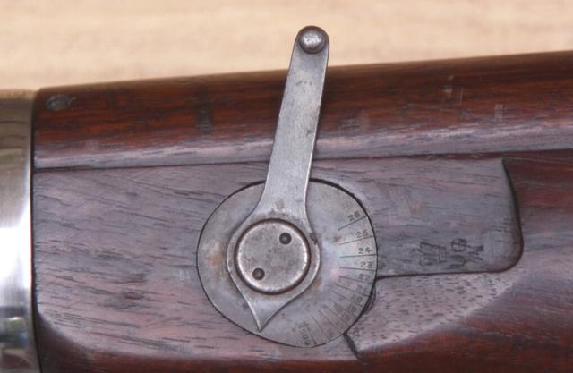

    What happened to P14 rifles made in US for Britain?
    I recently purchased a Winchester MkI* which escaped Weedon alteration and still has it's volley sights. The previous owner for some reason polished the lower band, trigger guard, bottom magazine plate and sling swivels to white, but other than that it's in great shape, with the bore gauging at .3035. (Excuse the sling - since fitted correctly!)
    A large number in the UKicon were eventually converted to 762 NATO calibre as target rifles, but these are now unpopular and very low price as a result, compared to original military specification examples.
