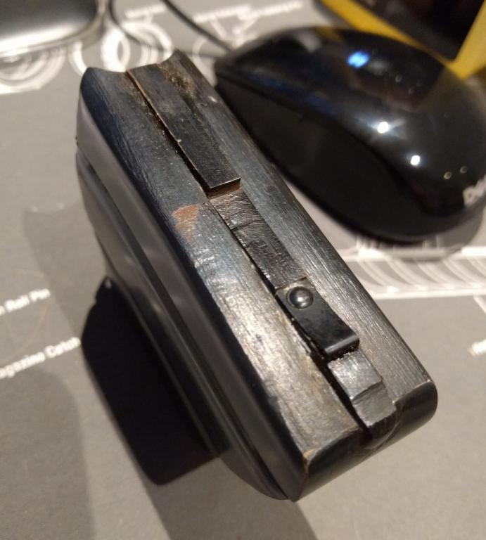

    Does anyone know why all the L59 D.P No4 rifles that Ryton Arms had for sale 2 or 3 years ago were just stripped down actions and barrels, deactivated, of course? There was no woodwork or mag that came with it and the mag was the hardest part to find, at a sensible price.
    Nick, has there been a bit of metal ground off the back of the SMLE mag in order for it to fit the No4 rifle?
    Not sure - I've never had an SMLE, so have nothing to compare it to...

    Quote Originally Posted by Nick S View Post
    That mag looks like it's been altered to fit a #4 rifle.
