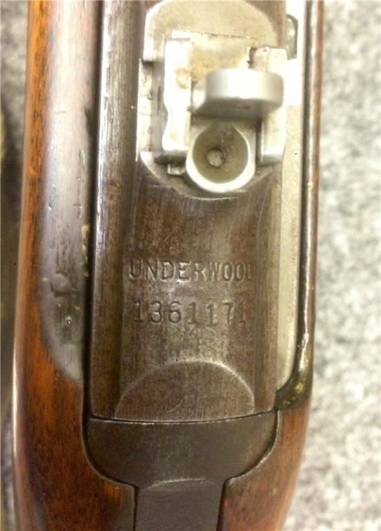

    Anyone with a Original or close to Original Underwood to a UEF 1,361,xxx that could compare with this one ?
    Or anyone for that matter that would look this over as if you were considering purchasing it?
    It's a pretty long time GB listing that has finally starting to come down in price.
    Curious to your thoughts......
    Like picture #19... Note the shape of the back/concave side of the short leaf.

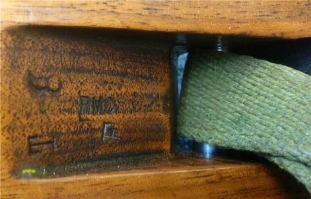

    How about the slingwell markings ?

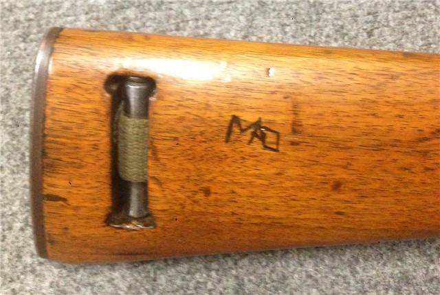

    And what appears to be 'Initials' on the right.... Do you think they spell MD ? Or MAD ?
    Or are they something else ?

    Leaf- Pic 19:
    Initials ?:
    Slingwell markings:

    Been relisted so you have another 6+ days to wonder about it. The RMC and the bomb are correct for the serial number but I don't know what the other two marks are.
    The rear sight seems to be just sitting in the dovetail and not centered. The recoil plate doesn't seem to have much wear on it compared to the rest of the carbine. The letters could be MO or MaO as well as MD or MaD. But the stock has been sanded and looks like a Tung oil placed on it? But it is early and number 11,171 produced by Underwood.

    Had grabbed a 1378,xxx that had the same slingwell markings... except the small bomb. His did have the large boxed UEF over GHD stamp though.
    Checkered safety on his also.
    Here a link to it:
    https://www.milsurps.com/showthread.php?t=30391
    Appreciate the help Bruce, And yes she's been sanded, Wondering if a Boxed UEF/GHD may have become saw dust or Was it ever there?

    NICE T F in the sling well. Absolutely correct. Some of those early stocks did not get the boxed UEF/GHD marling. I've seen them both ways. As for the sight not being centered, if it was properly sighted in, I wouldn't be a bit surprised see it off-center.

    Also have seen the same sling well markings..... but most have the boxed GHD/UEF and separate CC.

    In addition to the pics provided by Marcus, I've seen a 1.35 I cut with the T, F, RMC and Ordnance bomb marking in the sling well. Circle P on the wrist, Large UEF over GHD in a box, no cartouche.
