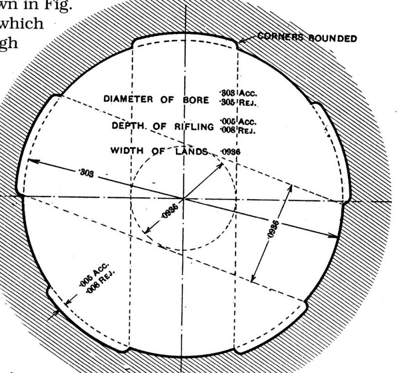

    A .318" groove diameter isn't really all that uncommon. If the attached engineering drawing (source?) is credible, it's actually within specs. Before venturing into oversize jacketed bullets, it would be worthwhile to try normal .311" to .313" projectiles. You might be pleasantly surprised.
    As for cast, I've tried unsized bullets dropping ~.316" in my 2-groove Savage that goes about .304"x.318". Accuracy isn't great but OK for short-range plinking and practice.
