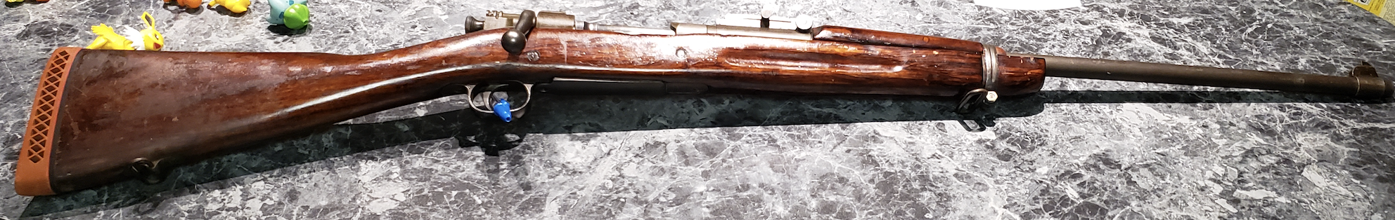

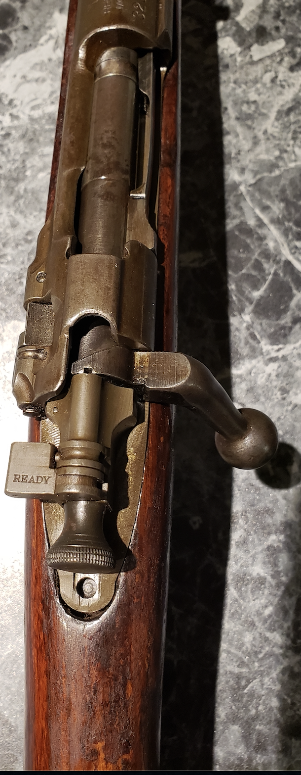

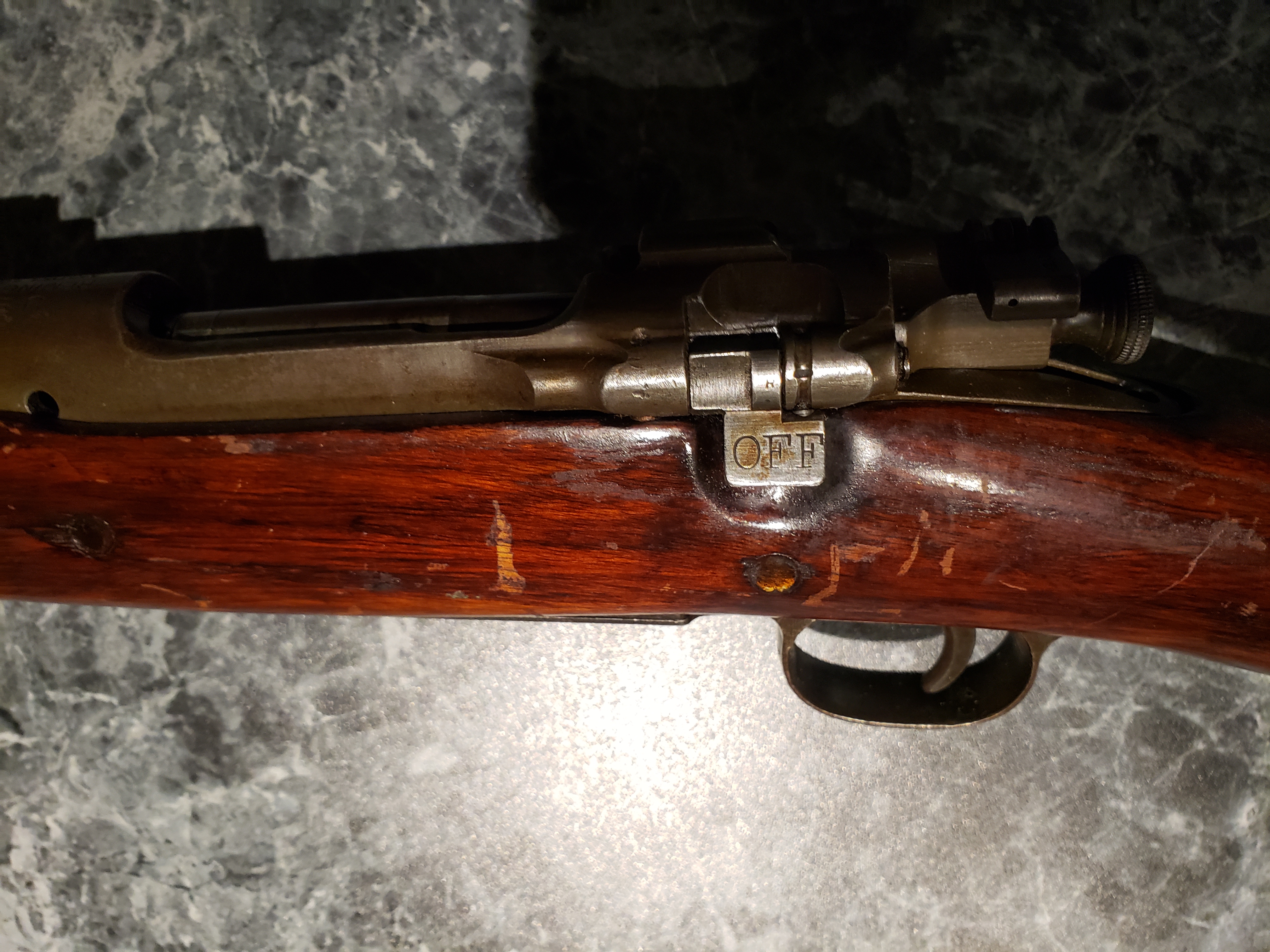

    I thought I was done, had enough, then saw this un. My heart throbbed, eyes tears up, and had it shipped home. Just picked up today. Since my previous bubba-un-done threads don't have pictures anymore, and I failed to keep the originals organized, I suppose I'll do another.
    Here is what we are starting with.

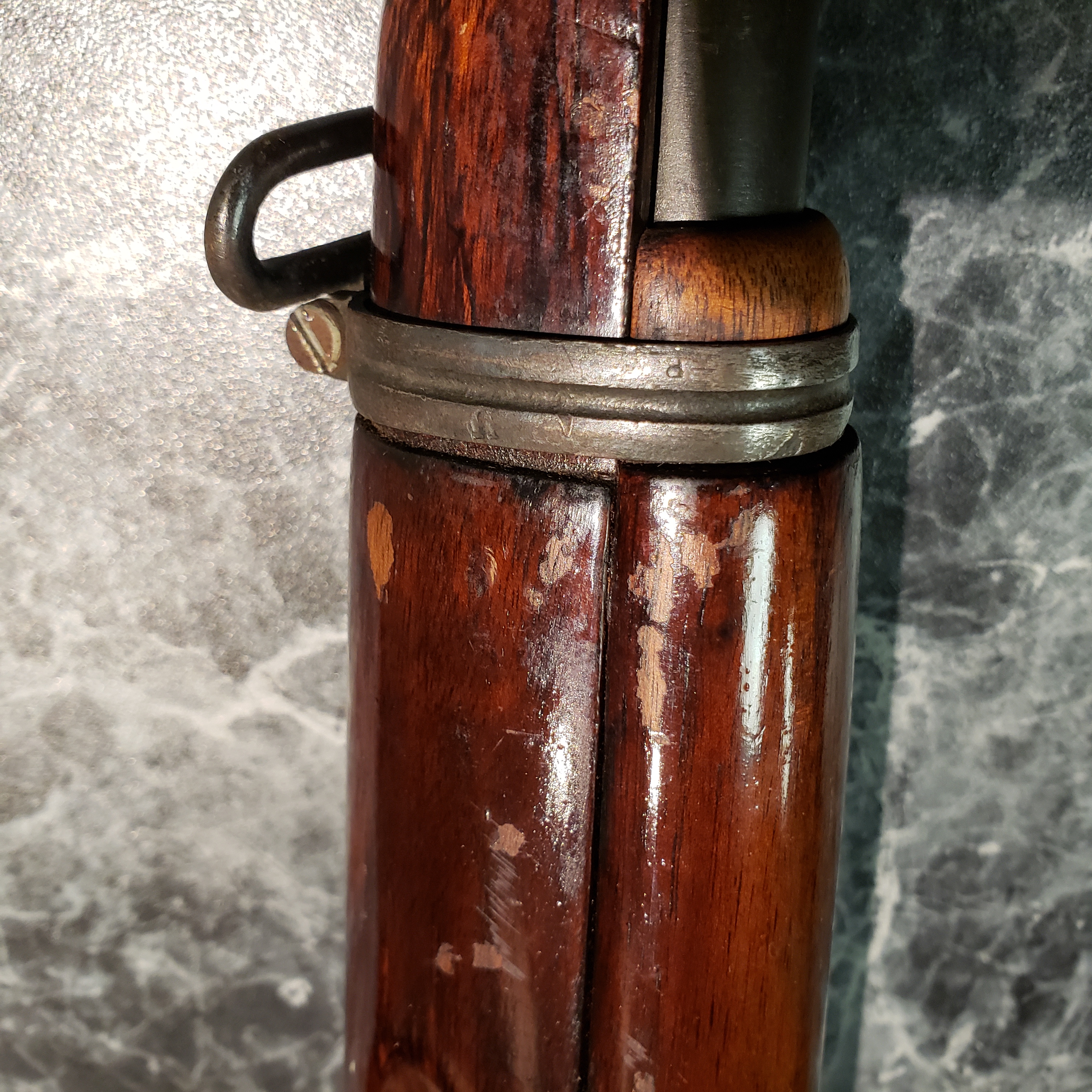

    There is no U on the upper band, but you can clearly see the "R", which is a rare find indeed! Hopefully the nut on the screw isn't there because the band is stripped out.
    At first look it seems to have all it's parts but the upper band - and everything has beautiful, proud showing R's.

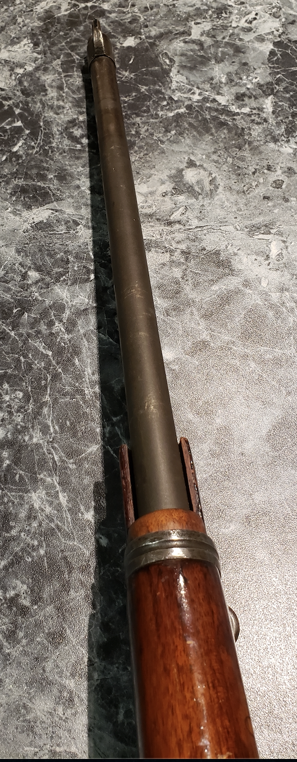

    The barrel has worn parkerizing, with clear stamp 7-42, and hasn't been cut back. We'll check the bore when we get it all taken apart for detail cleaning. Hopefully it's not a sewer pipe. The action was clean with light oil, let's hope that means it was well maintained and the bore is in good shape.

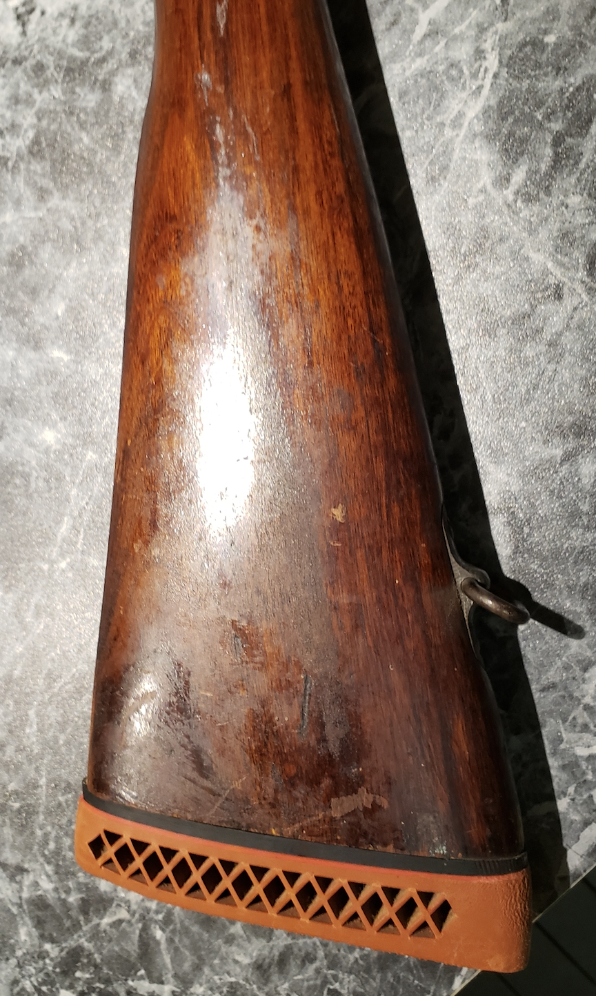

    Why does bubba have a propensity for varnished or shelac'ed stocks perhaps they felt it enhanced performance!

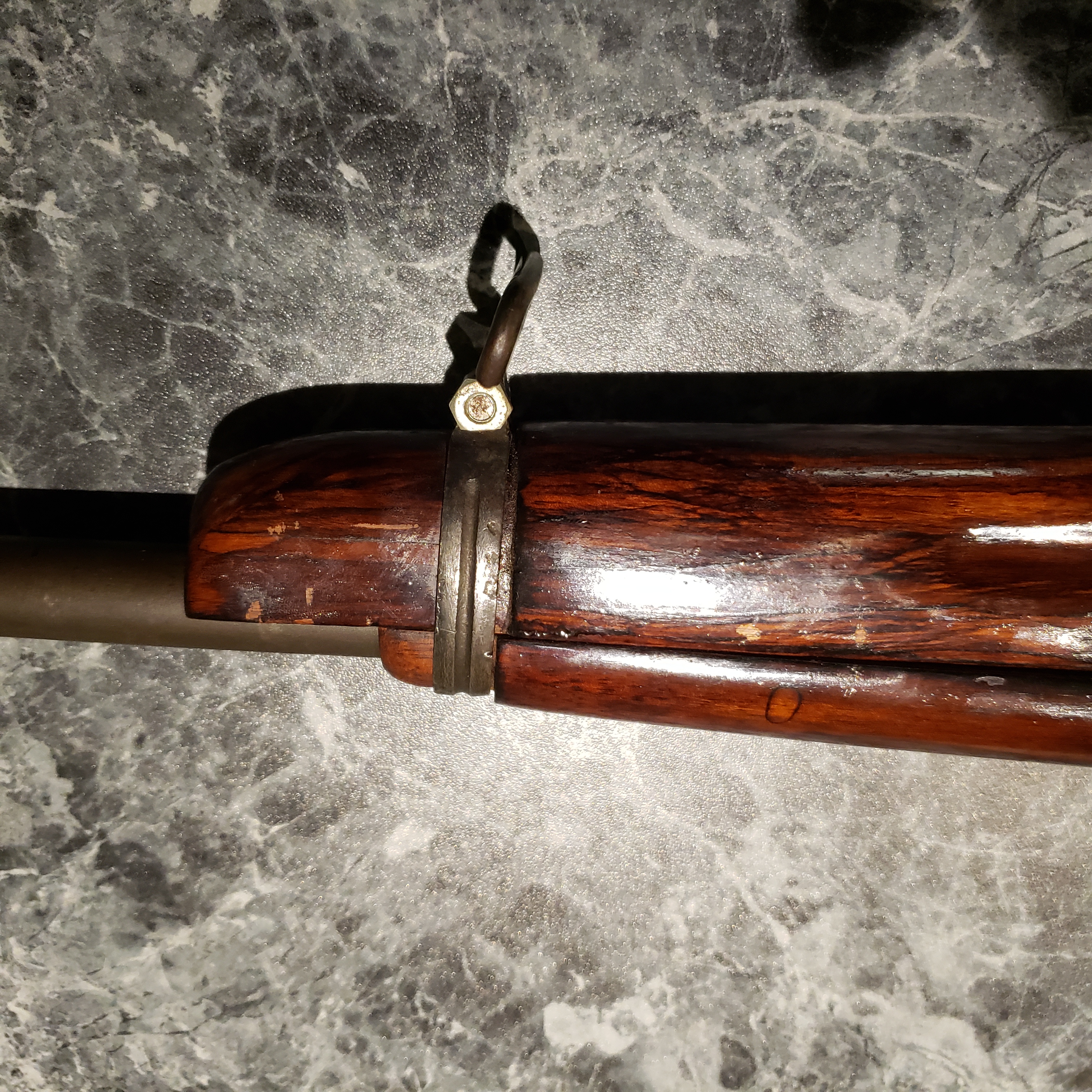

    In a few places where the shellac is worn off, you can tell that bubba never removed the original oiled finish, just slathered it on. It looks and feels like a mosin. My eyeball sees a nice bore though. Trigger group was encased in cosmolineicon. There is evidence of former pitting around the outside of the receiver. It was clearly removed and re-parked.
    I have read reliably accounts that this was common with marines in the pacific. They would religiously clean and oil, but no amount of frequency oiling the exposed exterior metal could keep the rust off in the salty island air.
    The lower band is a paperweight. The threads were drilled out or stripped out, larger course thread screw inserted with that nut on the end. I can maybe tap what is left and blue up a nice fine thread screw to make it look closer to right, or just put an old springfield band on it and enjoy my paperweight.

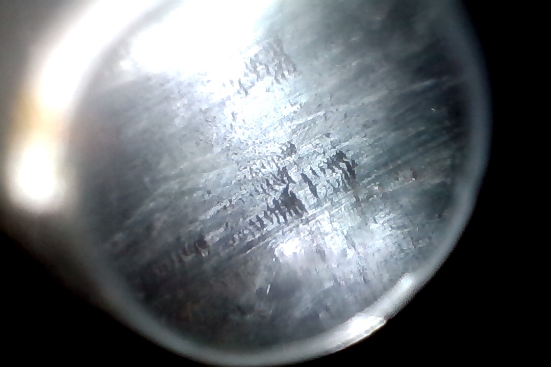

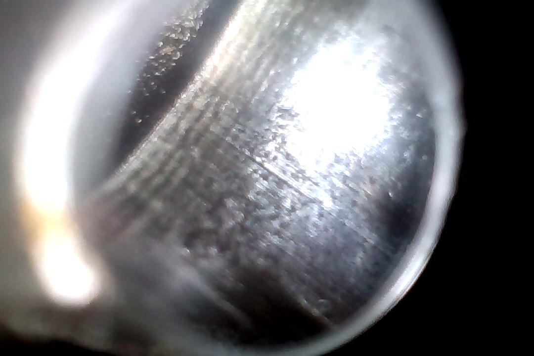

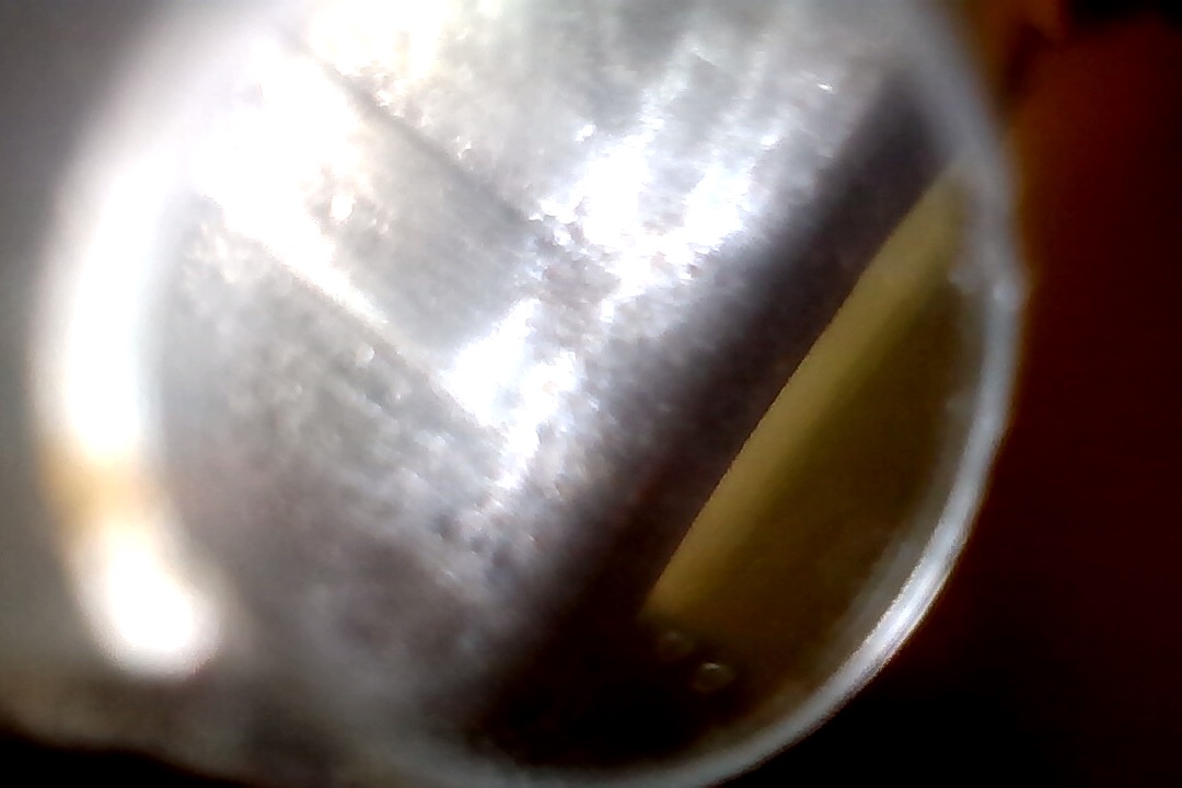

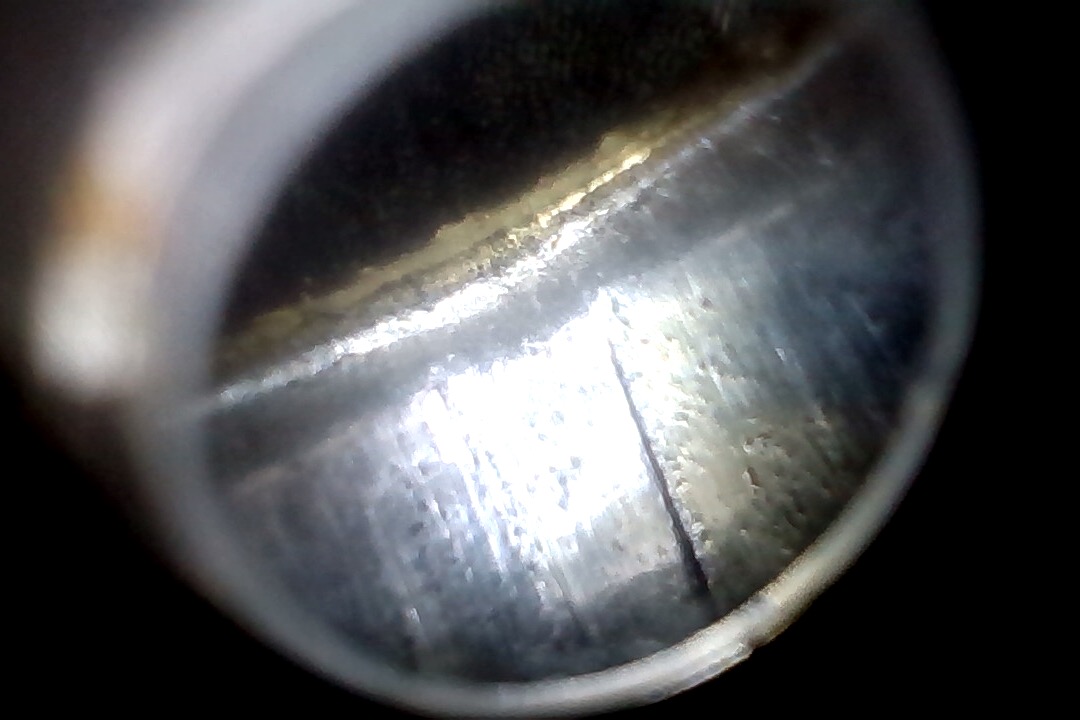

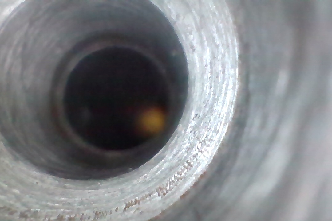

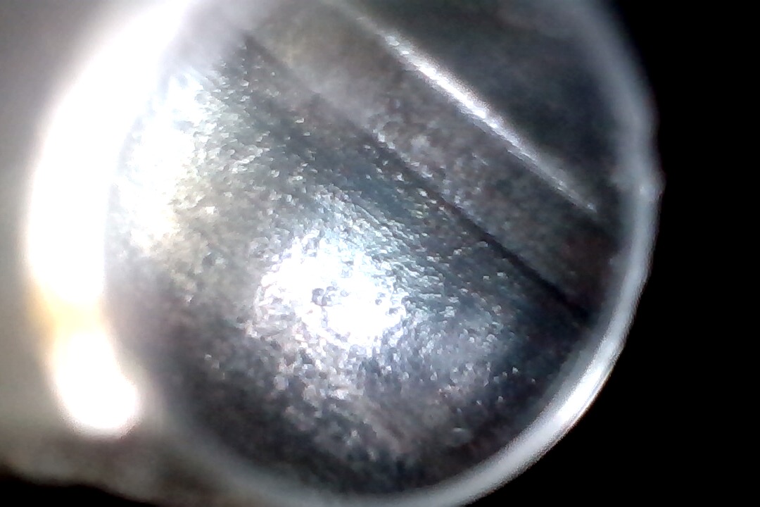

    Bore looks like it was at least maintained. Here we are before scrubbing...chamber had plenty of dried oil/grease, and some surface rust by mouth.
    pics are of chamber, freeborn area, mid bore and crown, as it was out of the box.
    I lightly scrubbed the chamber with my 800 grit bore-hone. Some reamer chatter on the shoulder showed itself, but everything cleaned up nicely. Not much to do with the bore. Little bronze brushing, little jb paste to polish it up. No rust, no copper, no carbon fouling. just old tacky oil.
    pics are chamber, shoulder, mid bore, crown.
    My muzzle gauge reads 0.3010

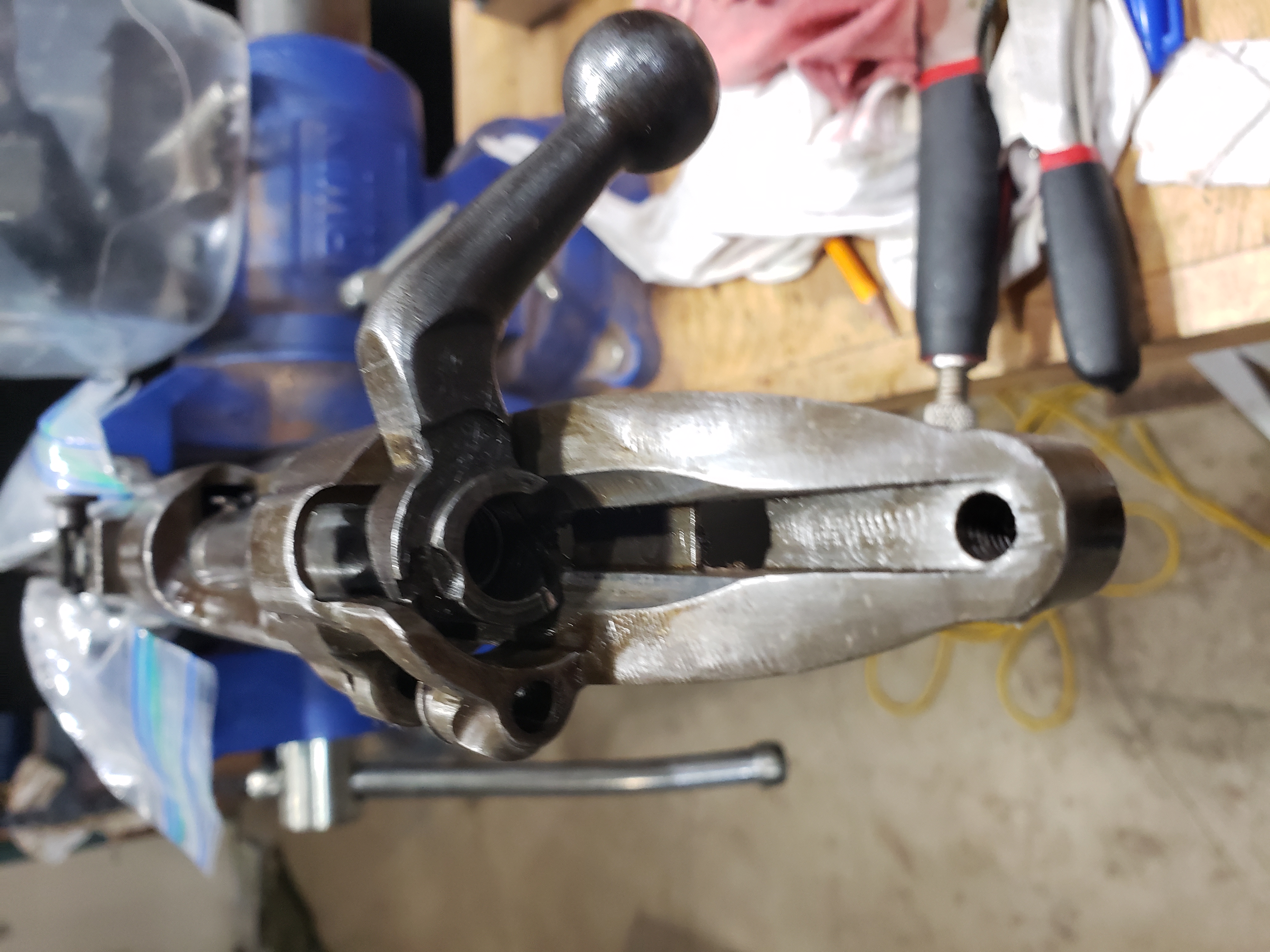

    Bore looks promising. Just an even light frosting throughout.

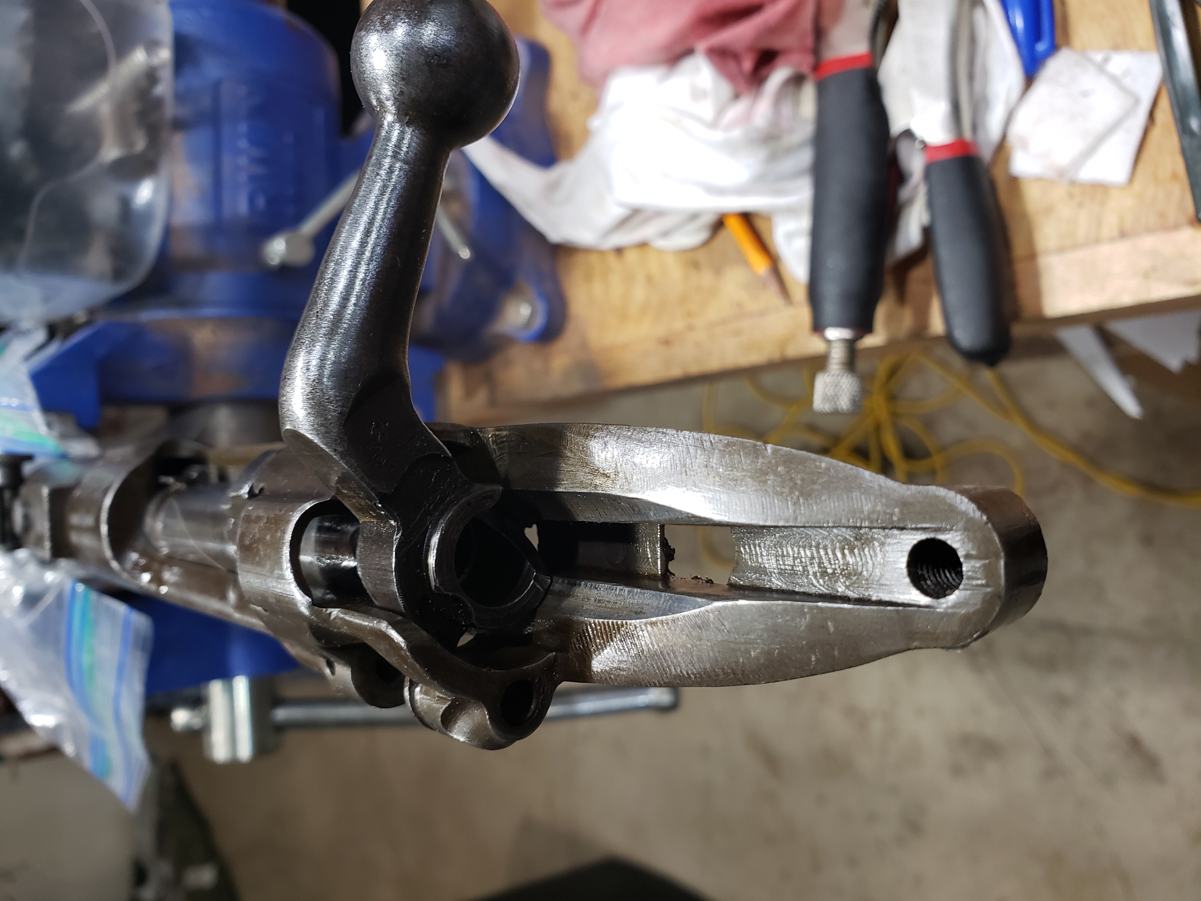

    I checked headspace after cleaning, but before I polished the chamber.
    Here we are on a go gauge before polishing
    Bolt stops in the same spot on one of MY live rounds (no fire control and trigger completely removed)
    Falls almost all the way on the gauge after polishing, and squeezes closed on a round.
    The chatter on the shoulder may be some raised burrs. I'll give it a very light chase with a finish reamer.
    There was some rust under the front sight base after cleaning all the dried grease way from the spline (no key on early <1943 barrels).
    I have a stock all ready for it. Just need to soak and scrub all the parts, reassemble, and see how it shoots before I decide what, if anything else, I'm going to do. I thankfully have some spare bands to get it range worthy.
