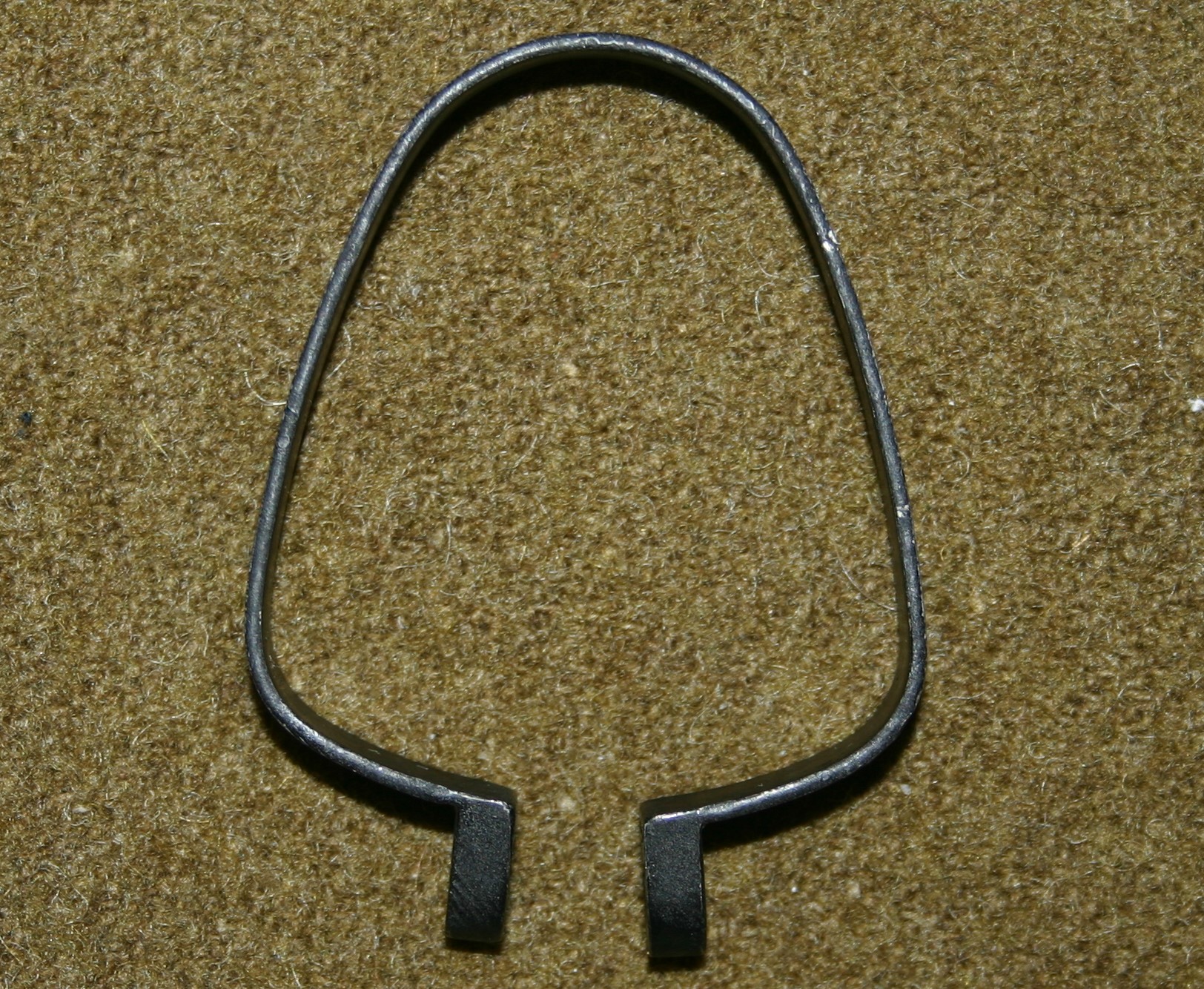

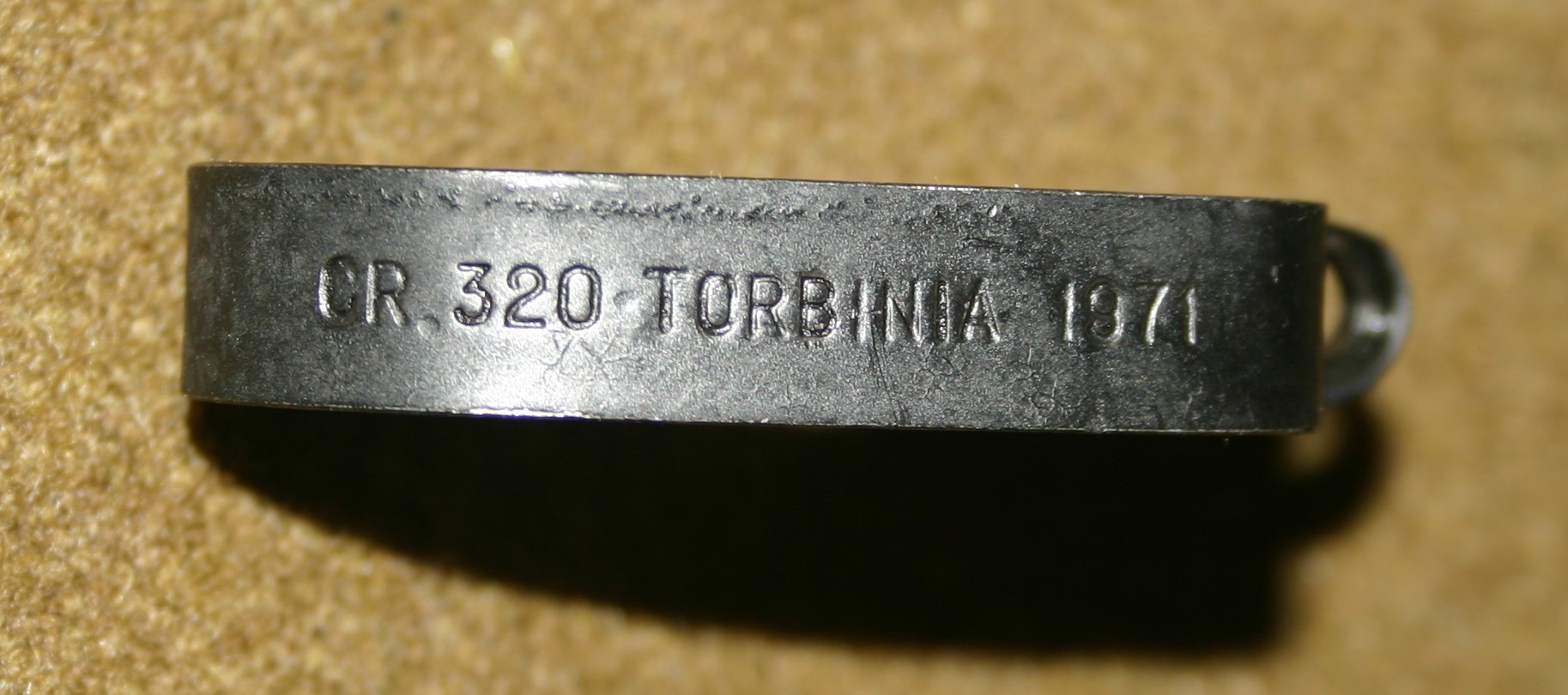

    I got this band in a lot i acquired and at first i didn't know what it was.
    After looking through Skennertonicon's i found out that the No8 Mk I and 7.62mm Enfield Envoy used them.
    Now what i'm wondering is was it used on other rifles like the L39A1 or the L42A1 ?
    Does it look real to you guys or is it a reproduction ?
    It's stamped CR 320 TORBINIA 1971
    And is this something rare, relatively rare ?

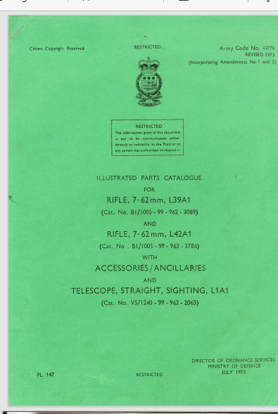

    It is certainly not an L39 or L42 band, the band on the L39/L42 is part number CR411 (NOT CR320)
    Source :
Name:	Screenshot (862).png‎

    Quote Originally Posted by tatou View Post
    Attachment 123139Attachment 123140
    Its a No8/Envoy front band that fits the fat beavertail forend they use.
    L39 and L42 use standard No4 bands on their cut-down No4 forends.
    Torbinia appears on some No8 bands and appears to be a genuine sub-contractor that produced a small batch of bands - probably because No8s themselves were built in odd batches.
    A relatively scarce part, and unusual in its markings. Not many people build up Envoys or No8s from scratch, and the bands often turn up on eBay.

    Thank you Alan & Thunderbox !!
    Exactly the info i wanted to know.
    (Guess i also proved i know nothing about those 4 rifles lol)
    Cheers guys !!

    Quote Originally Posted by Mk VII View Post
    I've got one of these as well, sitting here on the desk. One day it'll be wanted for an Envoy or No.8 build.
    It was the first time i seen one... not to mention a full line of text on a part.
    I have a friend that's looking for one for his No8 build but wanted to know and make sure it was the real deal before letting him have it.
