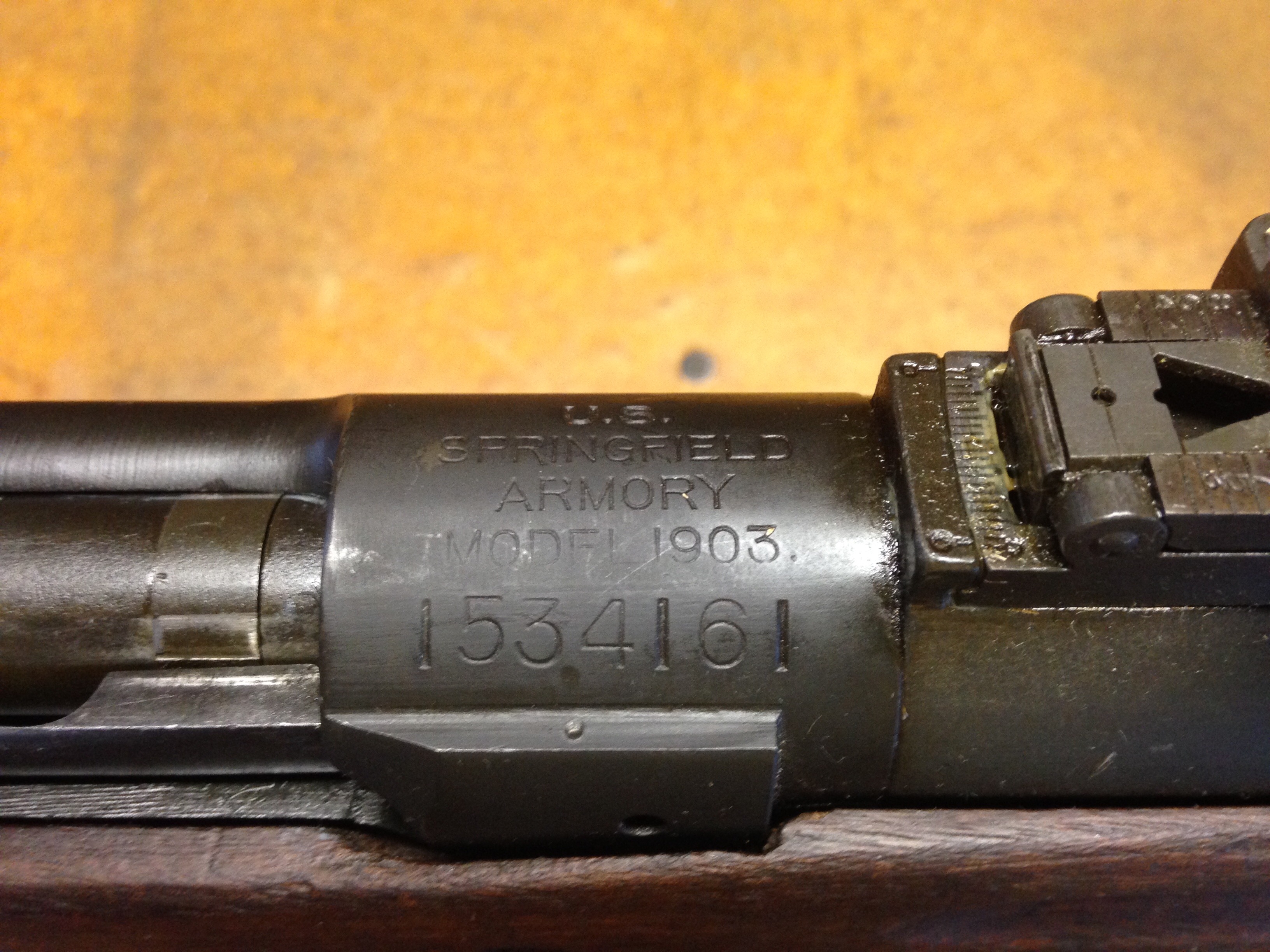

    Here is 1534161.

    Got it. Many thanks for sharing!
