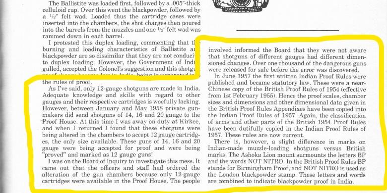

    Source :
    Extract from “Gun Digest 33rd Anniversary 1979 Deluxe Edition”
    Article Author : Mr A G Harrison
    Qualification : Former ‘Proof Master’ of the ‘Rifle Factory Proof House, Ishapore, India’
    Mr Harrison goes onto reveal some real horror stories - one example where the proof house receives some 20 gauge shotguns to proof, but as they do not have any 20 gauge proof cartridges they bore out the chanber to 12 gauge and use 12 gauge proof rounds - the shotgun is then marked up as a 12g.
