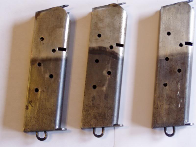

    The 1911 showed up at the door yesterday. It was better than described. I would put the total finish at about 60% or a little better. In some areas the blueing has faded but is still there, but on the forward strap the finish is almost entirely gone. It came with three Eley magazines, one in excellent condition with a serial no. (not the same as pistol) & two in very good condition. All are stamped & have the two tone finish. The .455 barrel is in a lot better shape than originally described: Shallow rifling with very light pitting in the grooves. I'd almost think it was the way the barrel was cut, as it is so light & uniform. I didn't go nuts trying to clean the bore, so maybe it could be removed? The ACP barrel came installed (like new) & it also came with another three ACP magazines. All in excellent condition. The gun is tight, with only a slight chip out one of the grips at the lower screw.

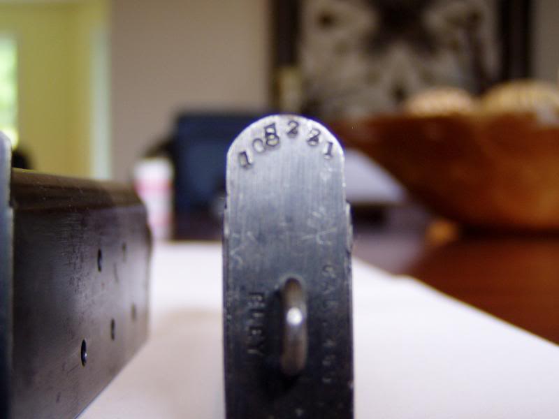

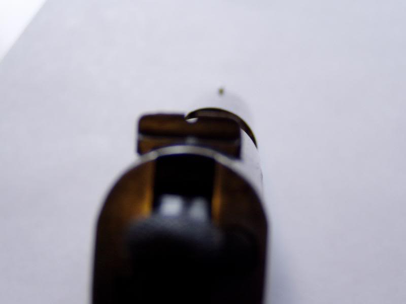

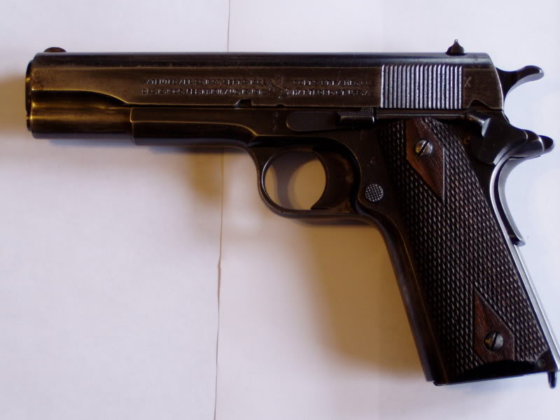

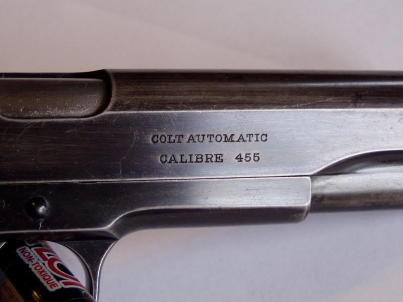

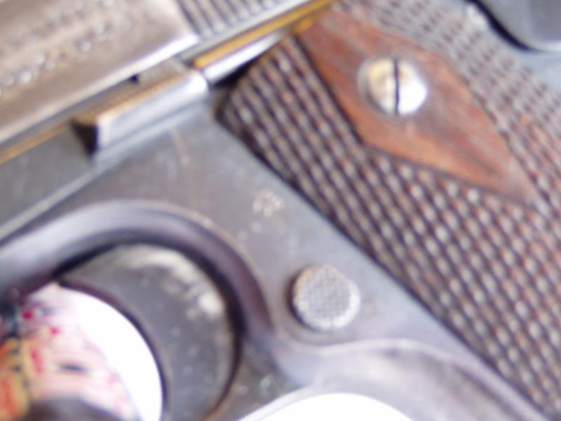

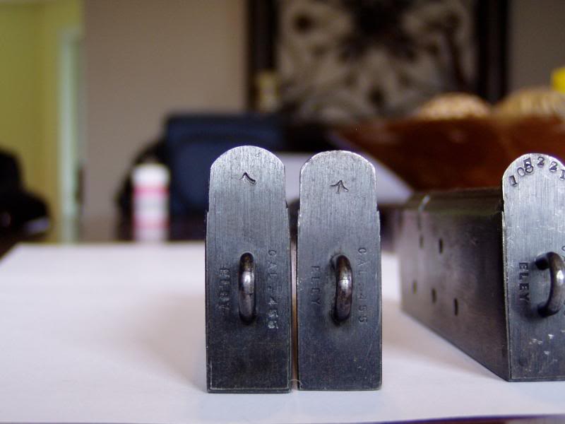

    Okay, its raining, expense claims are done & I'm on holidays. So here are some quick pics: (Just noticed the Pepto bottle in the background. Haven't needed this week, so far...)
