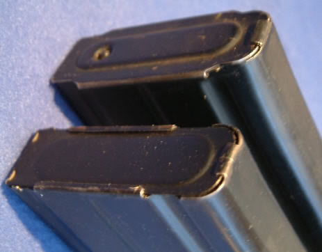

    Just to illustrate some of Peters comments on the L4A4 and L4A1
    L4A4 ejector block on left.
    L4A1 ejector block on right with hold open device 'button' behind the mag catch.
    Markings on an L4A1 X3E1 early 30 round magazine with FN locking lug
    FN locking lug top (L4A1 type)
    Commonwealth locking lug bottom (L4A4 type)
    The L4A1 magazines were shorter too (only fill with 28 rounds ?)
    The bottom plate on the FN locking lug magazines was internaly retained which was altered to externaly retained on commonwealth lug mags.

    Oh yes, I almost forgot.......... with the early magazine the bottom lips folded IN and it meant that in the dark, wet or in a hurry, you could insert th magazine upside down where it fails to feed! See KG's photos
    Good to see the old troublesome A1 ejector block and hold open device again. They weren't interchangeable so an L4A1 couldn't be upgraded either
